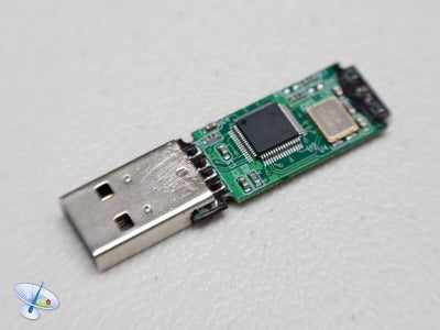

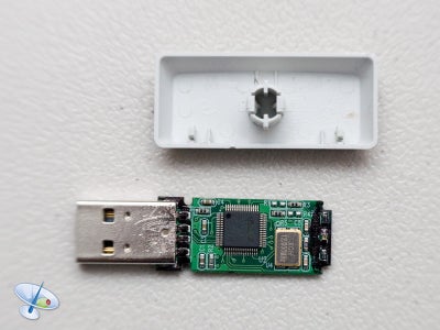

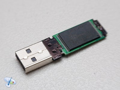

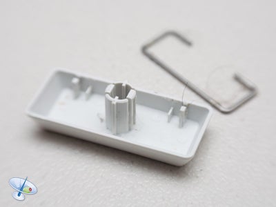

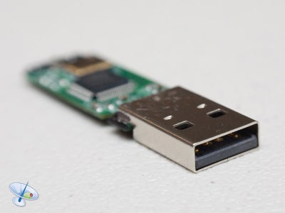

Once I had successfully freed the USB drive from its lame shell, it was time to think. Whatever am I going to put this little thing inside? And so the search began. I thought about doing a better Lego mod - unoriginal; ChapStick - too thin (I've been informed that somebody else has made a ChapStick USB drive); film canister - too fat; USB cable shell - too short; gutted iPod - too spendy. Hmm... nothing on my desk was really striking me as a great idea. So the search continued. To the closet! As I rummaged through piles of miscellaneous electronics, cables, and computer accessories, I paused as I held an old keyboard in my hand.

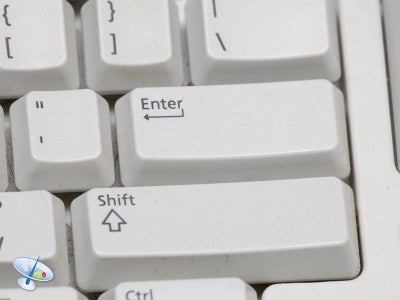

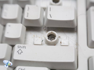

What to do with a keyboard, though? The PS/2 connection isn't large enough to accommodate the USB drive, and the keyboard is a bit bulky to be useful as a USB drive. Think, Kurtis... Think.
As I stared at the keyboard, I noticed some tasty treats (well, they used to be tasty) peeking at me from between the keys. Gross. Ah, wait a second, the keys! Oh sweet, blessed keys.
There are a decent number of keys on the keyboard which look like they could be just big enough to squeeze a USB drive inside: Tab, Shift, Backspace, Enter, Delete, and +. After careful consideration and a quick coin toss, I decided the Enter key would make the best case for my custom USB drive. It sort of makes sense, after all; "Enter" your USB drive into the USB port, with an arrow to help the less technically inclined. Tab is just plain confusing, with the two arrows pointing in either direction, Backspace and Shift don't sound cool, and +... well, + isn't even a word. Stupid +.

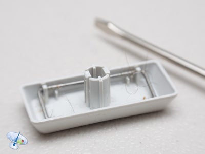

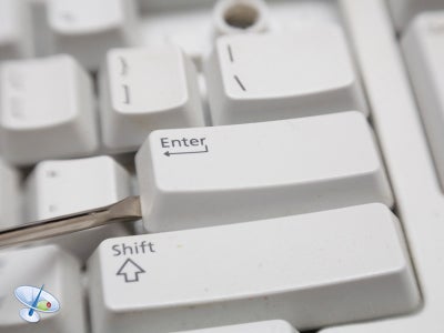

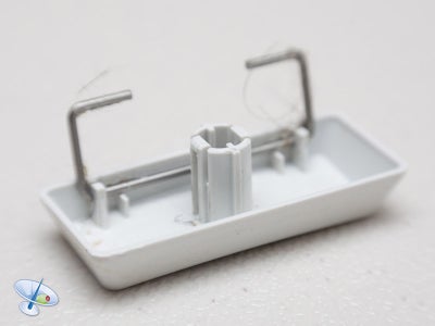

Removing keys from the keyboard is easy enough. Using a small screwdriver you can gently pry them off. In my case, the Enter key had a bar stretched across its width to ensure uniform key presses - I just ripped it off. Enter key removed, I check to see if the USB drive fit... and it did - with a little room to spare.
Before hacking away at the Enter key, I decided to perform a practice run on the Backspace key (I only had one old keyboard to work with and didn't want to ruin it, after all). And I'm glad I did.

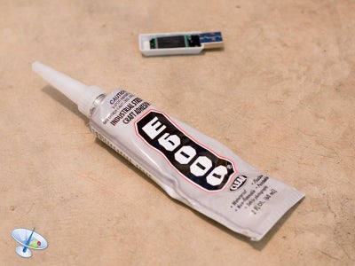

I was really glad I did a practice run. The day after I finished applying it, I was not happy with the clarity of the silicone; it was too cloudy. It was also a bit softer than I wanted.
So, I decided to use something else for the real thing: an industrial strength adhesive called E6000, which Brian has used in the past and recommended. That being said, about a week later I checked the silicone again and found it to be much harder. Apparently, it just needed more time to set. Still, the clarity wasn't quite as good as I wanted so I still planned to use E6000 in place of the silicone for the real run.

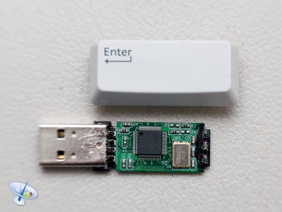

After the practice run, my plan of attack remained mostly the same, except for the first and last steps:
1. Remove clutter from inside the Enter key.
2. Dremel a notch into the side of the key.
3. Sand edges smooth.
4. Place the USB drive into the key.
5. Pour E6000 industrial strength adhesive into the key to secure USB drive into place and allow the back side to be see-thru.
Before pulling out the Dremel, I donned my protective gear. Kids, don't try this at home. I'm a trained, erm... heh... professional. Yeah.

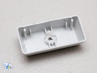

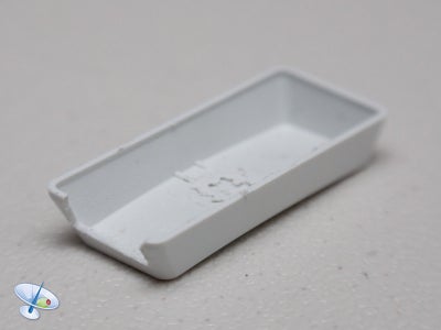

Step 1:
The first thing I needed to do was get the little stub in the middle of the enter key out of my way, as well as the little pieces of plastic jutting out that supported that bar I removed earlier. For the stub, I bashed the key with a large stone. No... why would I do that? Safety in mind, I proceeded with my Dremel and fingerless gloves. The cutting wheel was used to cut in some notches first and then the grinding stone was used to actually remove pieces. Using only the grinding stone on plastic tends to melt it all into one big sticky mess. By cutting notches first, I was able to use the grinding stone pretty much exclusively to remove the little plastic pieces that supported the bar.

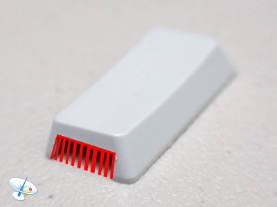

Step 2:

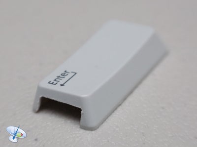

Before cutting a notch into the side of the Enter key, I grabbed a pencil and the USB drive to mark approximately how far I needed to cut. Once again I used the notch-then-grind method with the cutting wheel and grinding stone for the side of the Enter key.
Step 3:
I was able to clean it up pretty well with the Dremel, and then put on the finishing touches with some fine grit sandpaper. Care had to be taken with the sandpaper to not round any corners or edges, though.

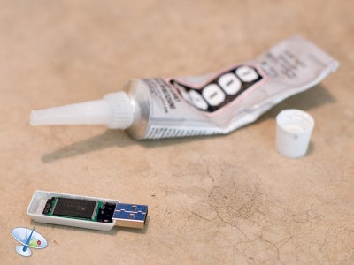

Step 4:

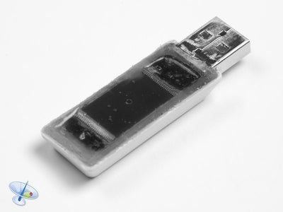

With all the necessary cuts having been made, it was time to place the USB drive inside the Enter key. Fit was perfect, with a little bit of wiggle room.
Step 5:
Now for the fun: pouring in the E6000. The tricky thing was that this part had to be done a bit at a time, rather than all at once, to keep the E6000 from flowing out of the notch we just cut. So I started by filling the key up to the notch and then setting the USB drive back in place on top of it. I let it set for 24 hours, then added a bit more, and so on, until silicone was up to the top. Once I was completely finished, I let it set for another few days before messing with it, since I used a good bit more E6000 than your typical application.

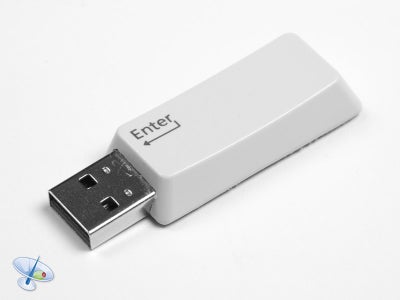

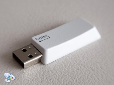

Step 4: Conclusion & Photoshoot
Project: Enter the USB was created by Kurtis Kronk for TheTechLounge.com. You can see the original article published online here.

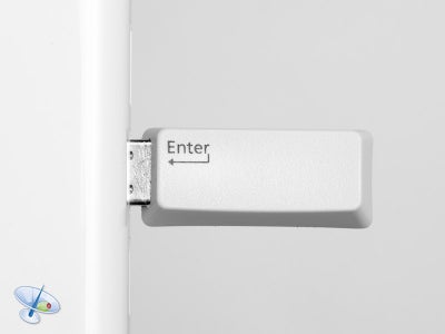

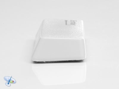

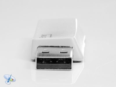

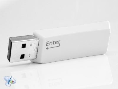

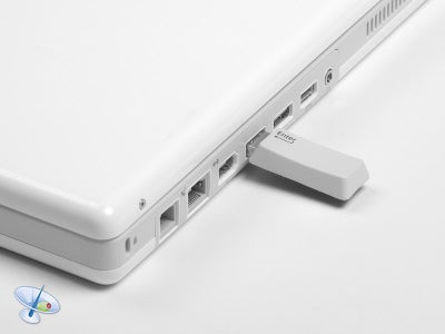

One extra finishing touch that I didn't anticipate was that, when the E6000 had finished setting, it was a little higher than necessary around the edges and wasn't totally flat. To correct this, I got the Dremel back out and used the grinding stone to roughly get the edges level. Then I grabbed some sandpaper of various grits (from 400 ~ 2,000) and got the E6000 surface flat and smooth to my satisfaction.
It isn't perfect and, if I had it to do again, I would have thought of a better way to make the E6000 nice and level without having to take any corrective measures after the fact. I've also thought about whether I should have chosen an opaque filler material, but then there is the matter of painting it to match the key. Overall, I feel Project: Enter the USB was a success.
If you've got a great idea for a USB drive mod, I encourage you to give it a shot. It's cheap, relatively simple, and lots of fun. Feel free to share your mods in our forums, or even submit your worklog to be considered for posting on TheTechLounge. Have fun!
