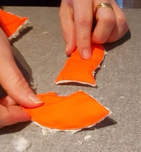

Cut out the pattern with normal scissors.
Step 3:
Put the pattern pieces on the fabric and draw around the pieces. The rectangular shape needs to be drawn twice.
Step 4:
Cut the drawn pieces out of the fabric.

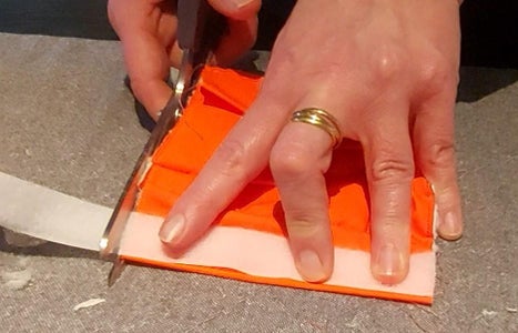

Step 6:
Cut out the lining following the shape of the fabric patterns.

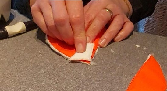

The patterns A1 and C need to be sewn together in the curve (dot) and onto each other.

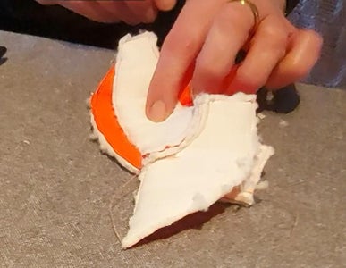

Step 8:
Sew together B1 and A1 at the triangle.
Step 9:

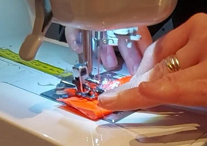

Sew together A2 and B2. The straight seam XX and square and the curve with XX and square need to be on top of each other.
Step 10:
Sew together the parts you just worked on.

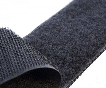

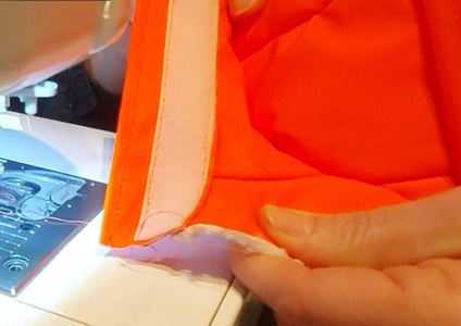

Put the soft and hard velcro on the D part and cut them so they fit.
Step 15:
Sew the soft velcro on the right D pattern close to the edge on the outside.
Step 16:
Sew the hard velcro on the left D pattern close to the edge on the inside.
Step 17:
Sew the circle on at the bottom from velcro to velcro. (close the bottom)
