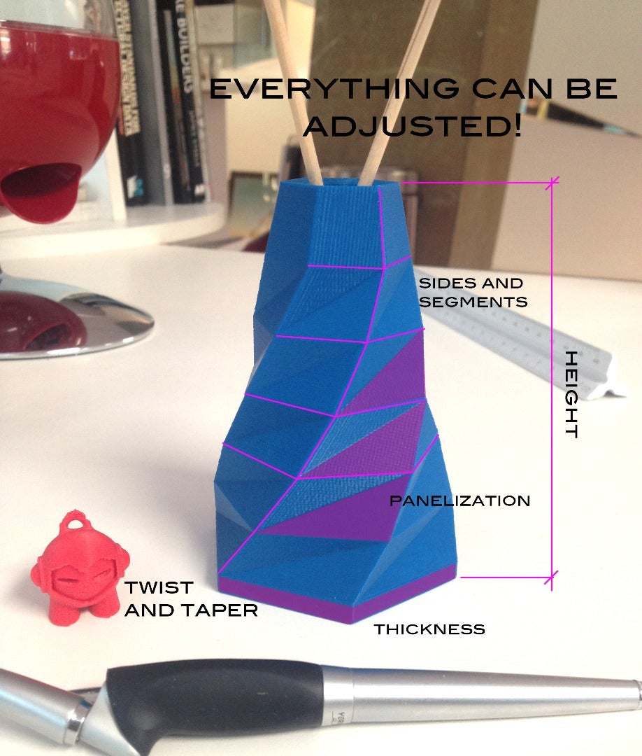

Hello World! Thanks for checking out my first ever instructable, created for the 3D Printing Contest. I'm going to show you the process used to create a parametric, low poly-count vase that you can not only download and 3D-print, but also completely customize through the use of eight adjustable settings built into the grasshopper definition!
For me, one of the coolest things about 3D printing is the feasibility of becoming a creator instead of just a consumer. With a product that's generated from a computer, customizing, tweaking, and tinkering with the parent file can create so many cool results! For this instructable I knew I didn't want to just make one static object, because for me, that's not what 3D printing is about. Instead, I wanted to create a platform for anyone to use so you can create something unique! So whether you want something sleek and tall or short and round, this vase will truly be your own! If you like this instructable, please vote for it for the 3D Printing contest! :)

No worries! If you list your settings in a comment I will plug them in for you and send you a link to download your custom vase. The different settings (which are in bold when they appear at each step) used to create the vase are as follows. Use centimeters!
Height; # of Segments; # of Sides; Twist (in degrees); Bottom Taper (radius); Top Taper (radius); Panelization Amount, Thickness
