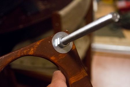

Step 10: The Removable Growler Holder - Putting It Together (3 of 3)
Stacking the 2 pieces on top of each other and lining the up, I then drill a hole through both of them for the carriage bolts. I had a worthless drill bit cause I couldn't find my good drill bits so a few pieces broke off on the bottom of the bottom piece. I just glued them back on with wood glue. They would get covered with a washer anyways. The top piece only need a washer and nut on the underneath of it, while the bottom piece should look like such: nut, washer, wood piece, washer, nut. The whole assembly takes 4 bolts, 12 nuts and 12 washers.
