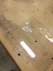

Step 1: Mark Your Edge
using a straight edge (ruler) score a line into your plastic
Step 2: SCORE!!!!!I Mean, GOALLLLLLLLLLLLLLLLLLLLLLLLL!!!!!!!!!!!!!!!!!!!!!!!!!!!!!!!!!!!!!!!!!!
continue to score your plastic along this line until it is deep and noticeable.
Step 3: Crack
Using tension, crack the plastic along your score line
Ta-duh! your plastic is now separated
