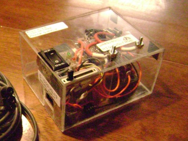

Step 2: Protoboard Boost Converter 500V
This boost converter is for those with moderate electronics experience.
If you have the resources I recommend making the printed circuit board version of this device because it is simpler, smaller, and less likely to fail. However feel free to make the protoboard version if space is not an issue.
This circuit takes up a minimum of 1.75" x 1.5" x 1" and can operate from 8.4V to 31.2V Input and output maximum of 500V safely (for the circuit). I recommend at least a 12V battery input.
DANGER HIGH VOLTAGE
This device can put out lethal voltages and the capacitors you charge can store lethal charges for hours, Please wear Electrician Gloves and Safety Glasses while operating and take all safety precautions
Specifications:
Project Cost:
- $17 + Shipping Mouser
- $5 + Shipping Coilcraft PCV-2-394-05L (Follow the link and type in the part number to buy)
- Average Total Cost with Shipping
-- $35 --
Dimensions: 1.75" x 1.5" x 1"
Input Voltage: 8.4V to 31.2V
Output Voltage Range: 100V to 500V
Output Power:
- 12V Input 36W maximum +-20% Charged 290J Capacitor Bank in 8s
- 24V Input 92W maximum +-20% Charged 1468J Capacitor Bank in 16s
Output Power Measured with 1-2 12V 34Ah Lead Acid Batteries for a Virtually Constant Voltage Source
The Major limitation of how much power can be drawn from your batteries is the Battery Packs ESR
---For Best results used high current rated batteries or Batteries meant for Power RC Devices---NiCd are the best (with the exception of Li-poly)
