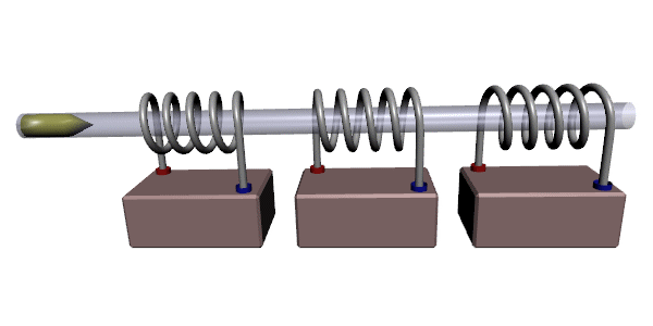

Basic idea is to take coil gun and bend it to the circle to have projectile speeding up round and round. Nice explanation about coil guns was made by electro boom channel https://www.youtube.com/watch?v=mdZo_keUoEs
My brother have little bit different thinking about this topic, mine explanation is: As you already know metal (or magnet) will stay at middle of energized coil, that means the biggest force is there just in center of the coil. Conventional motors never goes through the center, they are just passing it from the distance witch is space between rotor and stator allowing rotor to rotate and half of the coil length (also half length of the magnet, see picture attached). Thats why intention is to make length of the coil as small as possible. Problem is that with short length of coil, you have to wind more magnet wire, because length of the loop is increasing with all additional layers. For the coil: more loops = more force, more wire less efficiency.
