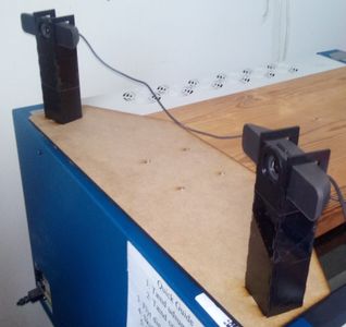

1. Two webcameras (Logitech C920C)
2. Infocus LP330 projector

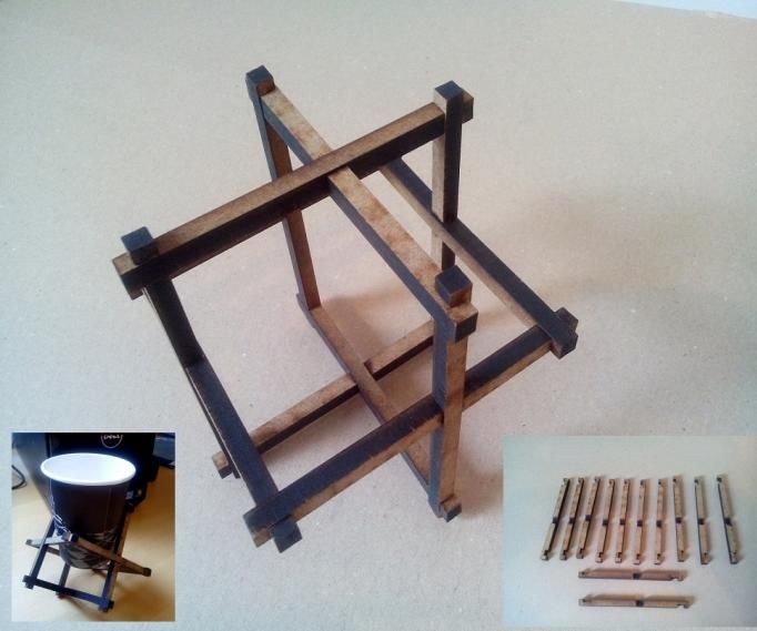

3. Camera and projector stand (made from 3 mm Acrylic plates and 6 mm HDF wood cut with a laser cutter)
Two cameras and projector should be connected to a computer with two video output like a notebook computer and the projector screen should be configured as an extension to main windows desktop. Here you can see images of cameras, projector and stand. The drawing file ready for cut are attached in SVG format.
