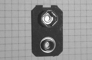

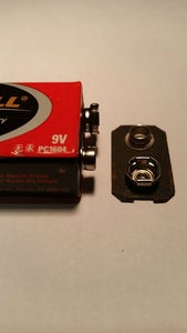

2: You will need one 9 Volt battery top.(see picture parts donor 9 Volt)
3. You will need one 9 Volt battery bottom.(see picture donor 9 Volt)

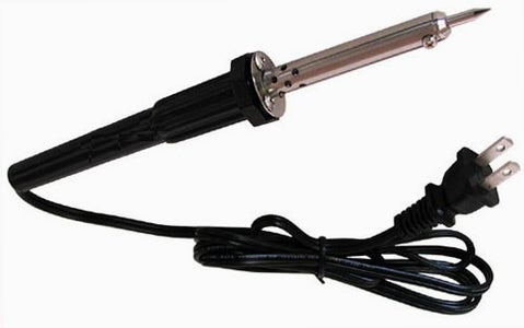

3. A soldering iron. (Be careful! It is hot!)

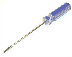

6. Small screw driver to pry open the battery(Be careful! Don't stab yourself!)

Here is a good look at some common 9 volt battery's and what there is in them for you to salvage. I like the Duracell's! for the donor battery.

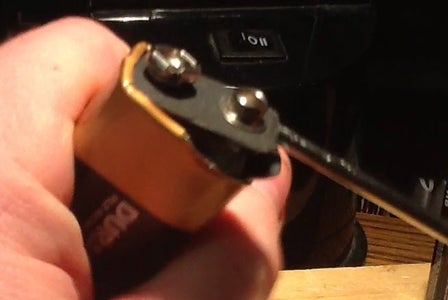

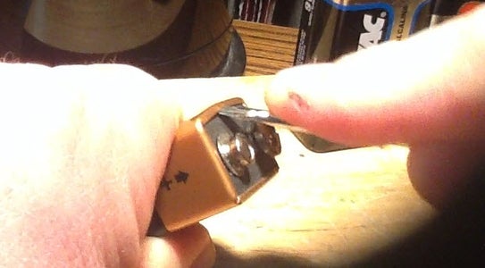

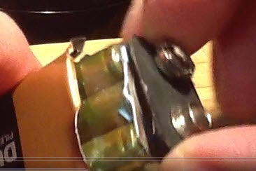

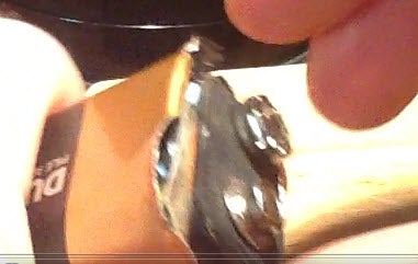

First off be careful! don't stab your self with the screw driver or cut your self on the metal 9 volt case because it is sharp as a razor!
First pry up one side of the 9 volt as shown.
Then start to pry around the edge until it is wide enough to pull the inside out. As shown.

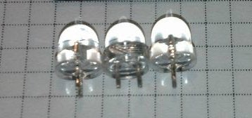

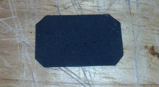

First place all three led's on there side lined up next to each other on the black 9 volt battery bottom and use the push pin to make small holes at the end of on the metal leads in the black 9 volt battery bottom you should have 6 holes. Note: Push just enough to get the tip of the push pin through, if you push it all the way through the hole will be to big.

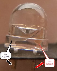

Now line up the LED's from minus to plus all in a row then push them through the black 9 volt bottom as shown. (see the picture on how to tell plus from minus on an LED.)

Now that you have the LED's soldered in place now solder on the power leads on and use your wacky tack to hold the leads in place as shown. Don't forget to check what side is positive and what side is negative check the picture on step two to figure this out if you don't know.
