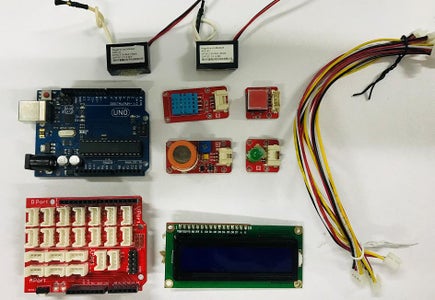

Here is a list of all the tools and parts you will need.
Electronic parts:
Arduino Uno R3
Crowtail- Base Shield for Arduino 2.0
Crowtail- Gas Sensor(MQ3) 2.0
Crowtail- Temperature& Humidity Sensor 2.0
Crowtail-LCD1602 Display
Crowtail- Button 2.0
Crowtail- LED 2.0
Negative ion generator x2
Some Jumper Wire

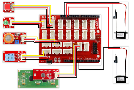

This is the circuit diagram of this project.
Connect all components according to this circuit diagram.
Sensors <--> Crowtail- base shield
Button <--> D4
LED <--> D5
Gas Sensor <--> A1
Temperature& Humidity Sensor <--> A3
LCD1602 Display <--> I2C Interface
Negative ion generator <--> 12pins,13pins

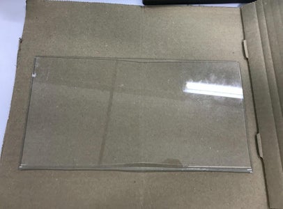

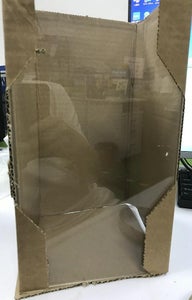

You can find a fully transparent box, but I searched around and couldn't find anything suitable, so I found some scrap cardboard and cut them into rectangles on three sides for the sides and back of the box. Initially, I tried to glue the sides and bottom together with double-sided tape, which was obviously a bad idea, and I ended up using a hot-melt glue gun.
For the front of the box, I used a piece of clear glass in order to be able to see the effect of the smoke elimination. The four corners of the front are the design that came with the carton, and I'm glad it adds a little design to the box.
Finally, don't forget to make a top cover for the box, otherwise, the smoke will flow out from above resulting in less effective purification.
So far, a box made of cardboard is finished!. It seemed to be easy and environmental.

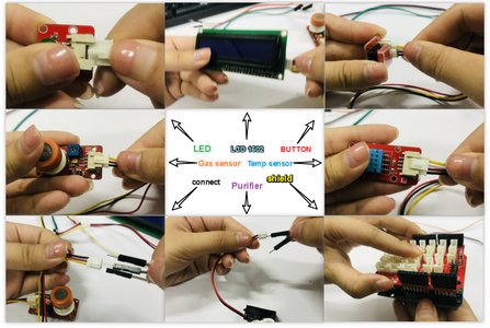

Next, it's time for the wiring part. Firstly, Take out our Arduino Uno R3 and Crowtail- base shield then stacking them together. The shield board is similar to a terminal block,which is very easy to plug in the wires and can be used flexibly to plug in servos and other devices.
Then connect the sensor cable to the Arduino-base shield with the pins as shown in the circuit diagram in step 2.
If you're curious to know how each module works, you can connect each module individually to test them out. Otherwise, if you're confident everything will be OK, just connect everything up.
