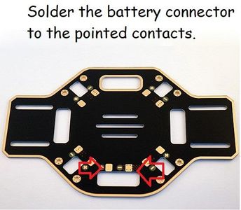

Step 1: Soldering the Battery Connector and the ESCs
PDB is the Power Distribution Board. It is the frame's bottom plate, with square pads all around. You solder the ESCs to the PDB as shown above. Check the polarity is correct!
Also, you can see an extra set of solder pads. These are for the battery connections. Solder the female XT60 connector to the pad. Check that the red wire is going to the positive contact and the black wire is going to the negative contact.
