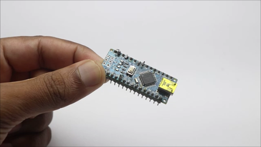

Arduino Nano from here

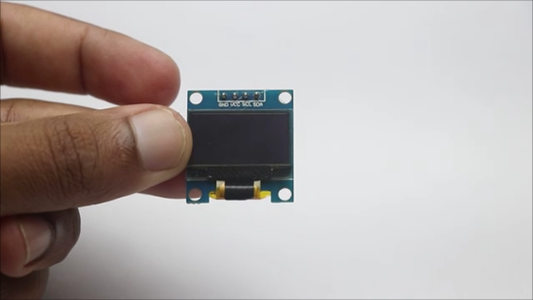

OLED Module

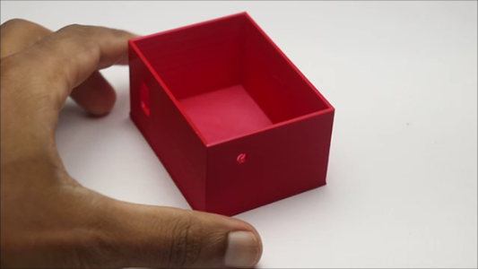

The First step that came to mind before making this project was the design.
I wanted this project to be small as possible and also should have great appearance at the first glance.
There was many other design that i made and tried but none of those excited me. I wanted the practical yet sleek design considering the standard size of the components.
IR sensor and the ultrasonic sensor comes in standard sizes so that if you are using these design you can use the design file and install the components effortlessly.

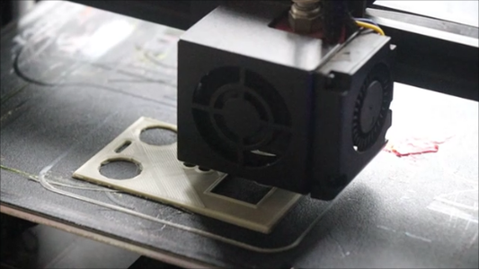

I designed the model using the tinkercad application and since it is not a very complex design you can make it effortlessly in some time.
You can simply use the files which i gave in this step, just open in the slicer and you can follow the settings that i used to get a good quality print.
PLA filament is the best choice to print this model and the choice of colors is totally depending on the users taste of color in my case it was red and golden yellow.
The Print time is not more, i was able to get the models printed in less than an hour and you can expect the same.
There is no need of any post processing after the model is printed, Now while the model is ready we can head over to making the electronics part

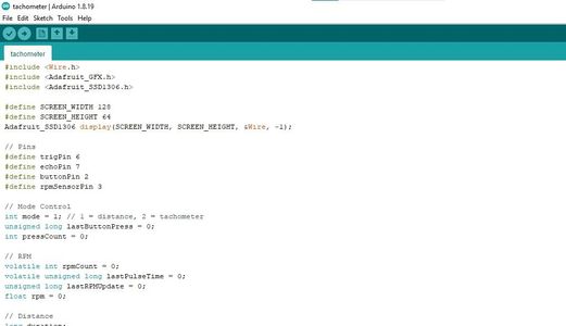

Step 2: Circuit and Program
The Circuit at first glance seems like a mess for most of the newbies who are seeing such connection for the first time!
Do not worry this is not as complex as it seems, i will make the circuit connections very easy for you by giving a step by step connection explanation.
Note that i used arduino nano in the project but the circuit is made with uno, the connections remain the same

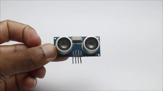

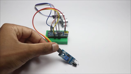

The circuit has 3 main components, The OLED, Ultrasonic sensor and the IR sensor and i will explain the connections
All these components has the Vcc and the Gnd terminals, Connect them to the 5v/3v terminal and all the Gnd to the ground of the arduino uno board.
Now the left over pins of modules is connected to arduino as follows
The HC-SR04 Trig to D8 and Echo to D7 pins
The IR sensor output goes to digital pin 6.
The OLED connections for SCL to A5 and the SDA to A4

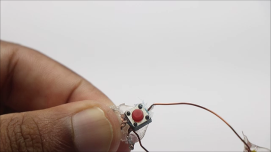

Toggle switch is connected between D5 and the Ground
You can even shrink the circuit by connecting all the gnd to one jumper and that cable is connect to uno directly, This reduces wire usage to large extent.
Now upload the program to board using the IDE, Connect the arduino board to computer and use the program given below.
Check for proper port type and board type and upload the program, once it is done test the circuit for working and if any customisation is required you can do that also.

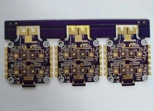

You can also replace this open circuit with a simple PCB, Complete your electronic projects in the best way from PCBWay
Why them? They have provided me with the best PCB, and the quality is just amazing compared to other providers in the market. They also have Color PCB printing check it out
They are now offering crazy discounts if you are using their 3d printing service, For prints over 64g, the discount is equivalent to 20%–80% grab it here
A revolutionary solution that combines the best of both rigid and flexible circuitry to elevate your electronic projects to new heights.
They also offering great prices for purple soldermask, As you know purple pcb are very expensive but not anymore, Check this out.
PCBA & Online quote available with 24hr delivery services
Their expertise in advanced manufacturing techniques offers seamless integration of rigid and flexible components, ensuring enhanced reliability, durability, and space-saving benefits.

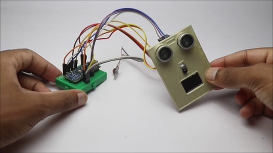

I will start by placing the electronics components that play the key role here, Thst is the IR sensor and the ultrasonic sensor.
Place it on the dedicated areas on the 3d printed thing and if necessay add tiny amounts of hot glue.
Double sided adhesive works pretty much fine for this purpose, Once you are done with the sensor paart rest of the cable hiding part! can be done.

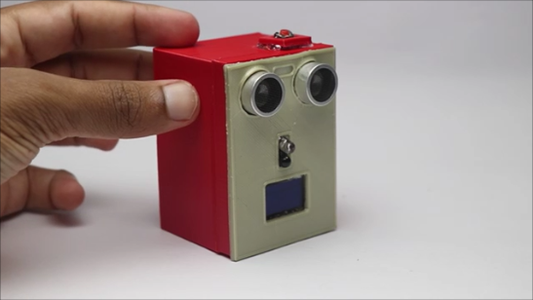

The jumper cables needs to be double checked for any disconnection during the process, Now if needed power on the device before sealing the base and top part.
After all the checks are complete proceed with sealing the top and bottom part, just use a tiny amount of superglue between these parts and gently press for some time and then you are good to go.
The toggle switch has a separate 3d printed frame that is connected to the top part and sealed using the hot glue or the super glue depending on you.
If you think that the circuit is conjested and you are not able to close the top lid just use the extender part, all you have to do is 3d print the extender and place between the base and the top.
At this point the building phase is completed and now we can head over to testing the project for its working.

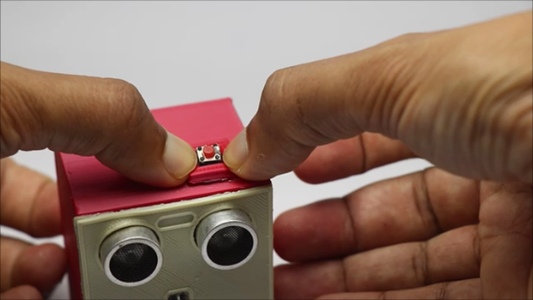

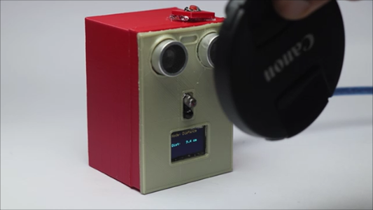

To use this device all you have to do is connect usb source to it and depending on you want the tachometer mode or the distance scale mode press the button.
On pressing the button you can switch between the 2 options and now if you are in the scale mode just place any object in front of the sensor and you will see the distance.
Press the button again for tachometer mode and now you can measure the RPM of the objects especially the rotating objects.
There is a catch here, supppose you want to measure the rpm of a rotating wheel, just attach a piece of white tape so that the sensor sense the obstacle between the rotation.
To explain in simple way its like the hump on a straight road so the sensor can read and give the readings properly.
