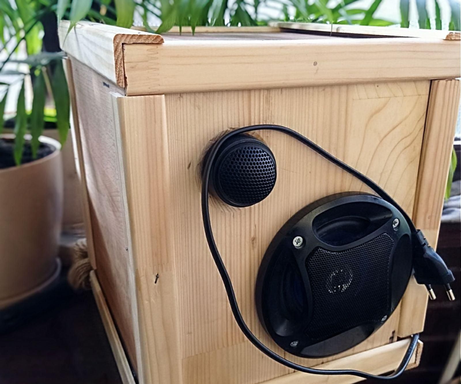

Step 8: Transmitter Box
I decided to use this small wooden box because it has a home decor type of look to it, and that makes it a great box for installing a PIR sensor in it.
In order to install a PIR sensor in this box, I first measured the diameter of the PIR sensor (10 mm), then I used a 10 mm drill bit to make a hole for a PIR sensor.
Step 9: Transmitter Box (electronics)
In this step install a small ON-OFF switch and a 9v battery connector.
Wiring it up is also simple and it goes like this: battery negative goes to the one side of a switch, then from a switch to the GND on the Arduino board, battery positive goes to the VIN pin on the Arduino board, and that is it.

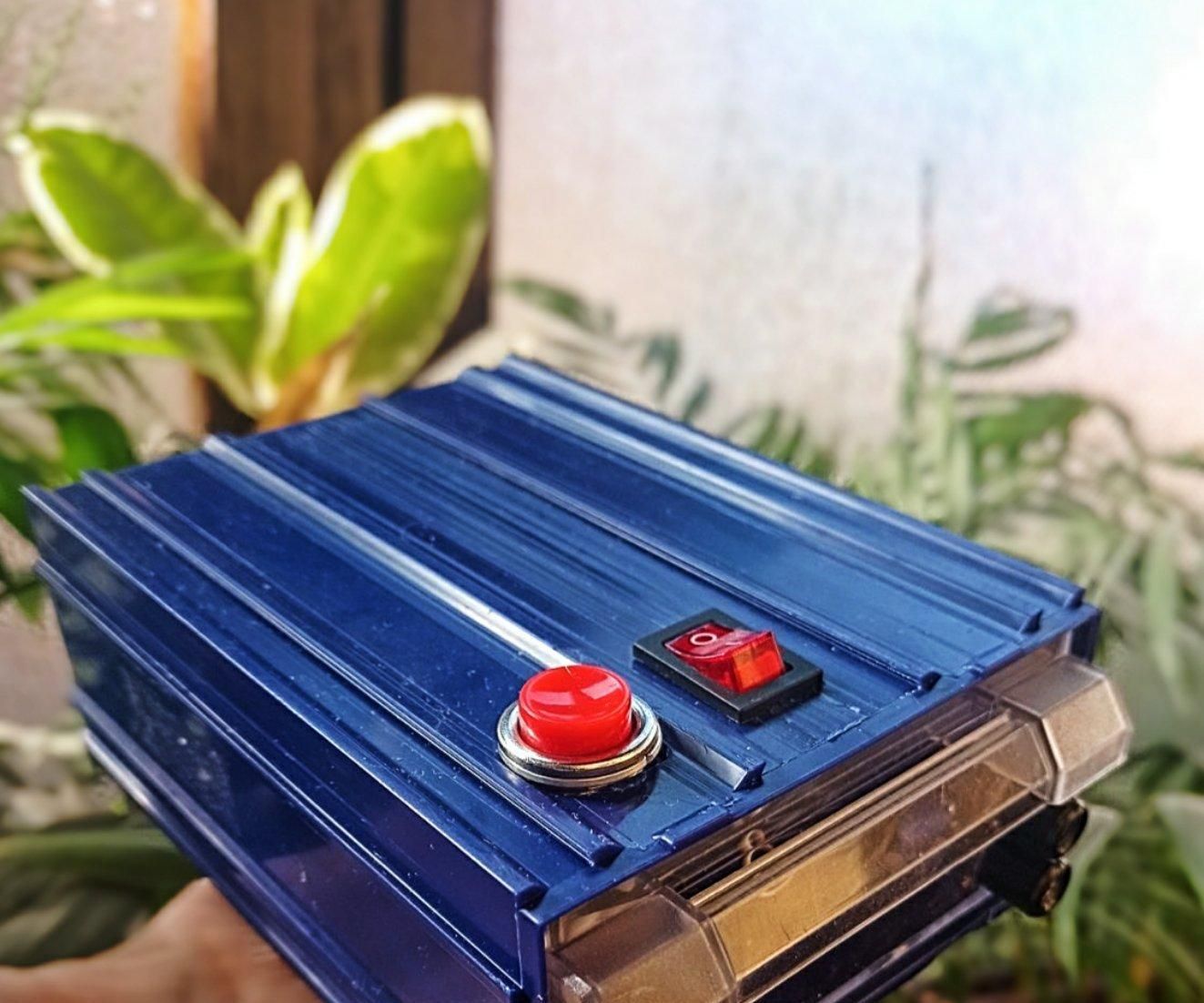

Step 10: Receiver Box
In this step make a hole for the switch and 5mm LED.
I first measured the dimensions of a switch, then I traced them on the box, and then I cut it out. And for the LED hole I used a 5mm drill bit.
Step 11: Receiver Box (electronics)
Wiring up this part is also simple, and it goes like this: battery negative goes to the one end of a switch, the other end of a switch connects to Arduino GND, battery positive connects to VIN pin on Arduino board and that is it.
