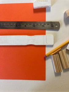

  1. 1 Footlong Paint Stick (you will be able to find it in Home Depot or Lowe's)
  2. 2 tumbling block pieces (2 in X 0.6 in X 0.4 in)
  3. 2 wooden cubes pieces (1.5 cm x 1.5 cm x 1.5 cm)
  4. Footlong Ruler
  5. Pencil
  6. 6 in Hacksaw
  7. White Acrylic Paint (optional if your paint stick is plain)
  8. White thread
  9. A pair of scissors
  10. Beading elastic thread (optional - For testing only)
  11. Beads (optional - For testing only)
  12. Beading Needle (optional - For testing only)
Step 1: Gather the Materials
As listed above gather all the materials. The last 3 optional items are only to test if the tool works as expected.

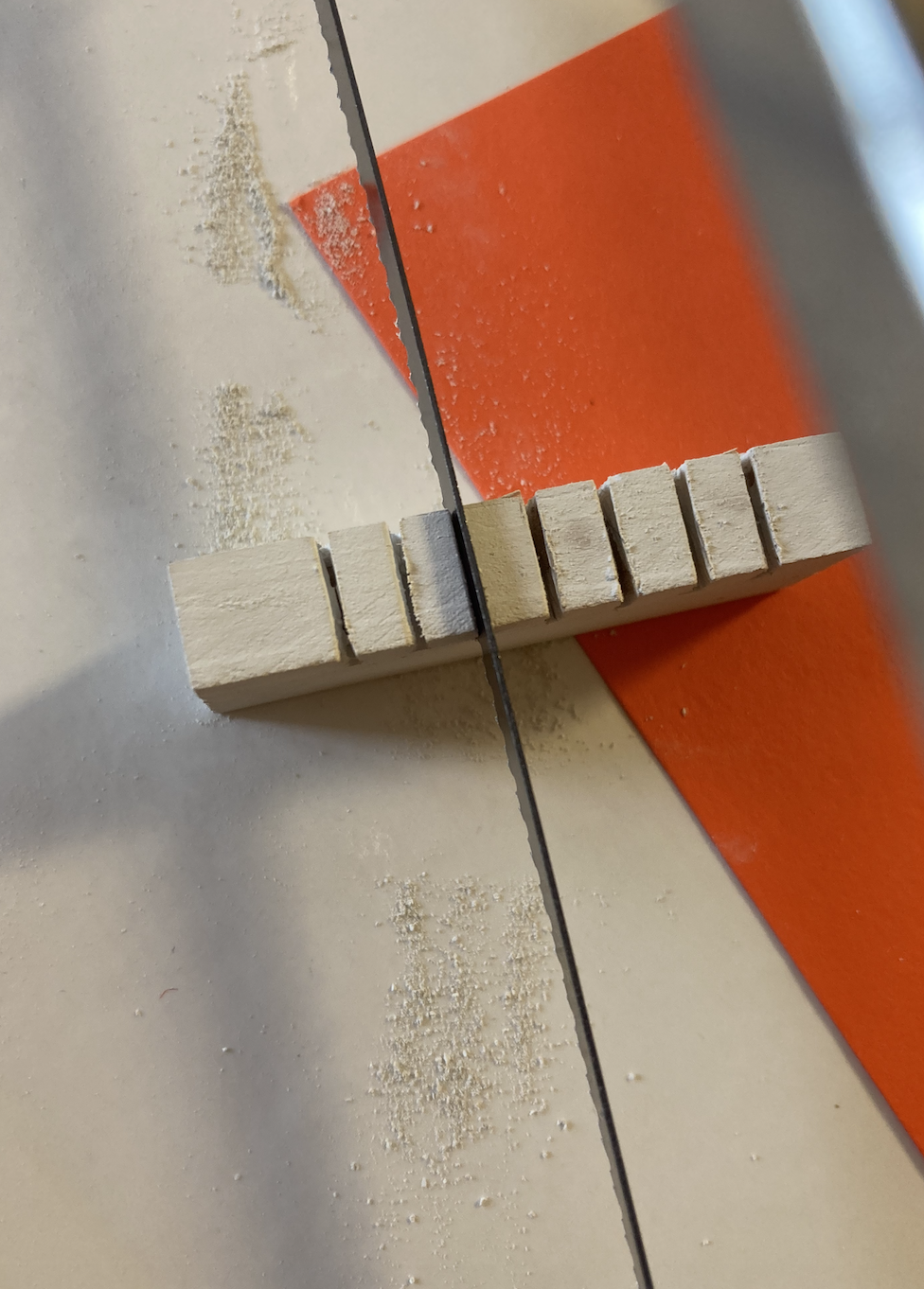

Step 2: Mark and Cut the Grooves

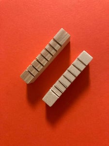

In this step, I marked the 2 tumbling blocks with an approx 4 mm distance. There are 7 such markings on each of the blocks. Using the hacksaw, I cut along these markings (lines).

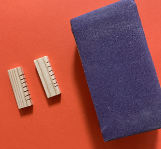

I have built this sanding block in school and I use it proudly at home for my projects. I choose to sand the tumbling block to make the groves smooth.

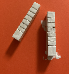

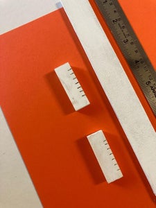

The footlong paint stick had some writings on it and I wanted to erase that. So, I opted to paint it white using acrylic paint. After that, I also decided to paint the 2 wooden tumbling blocks. After drying, I had to once again lightly handsaw along the grooves to make sure no paint has entered the grooves. Refer images.

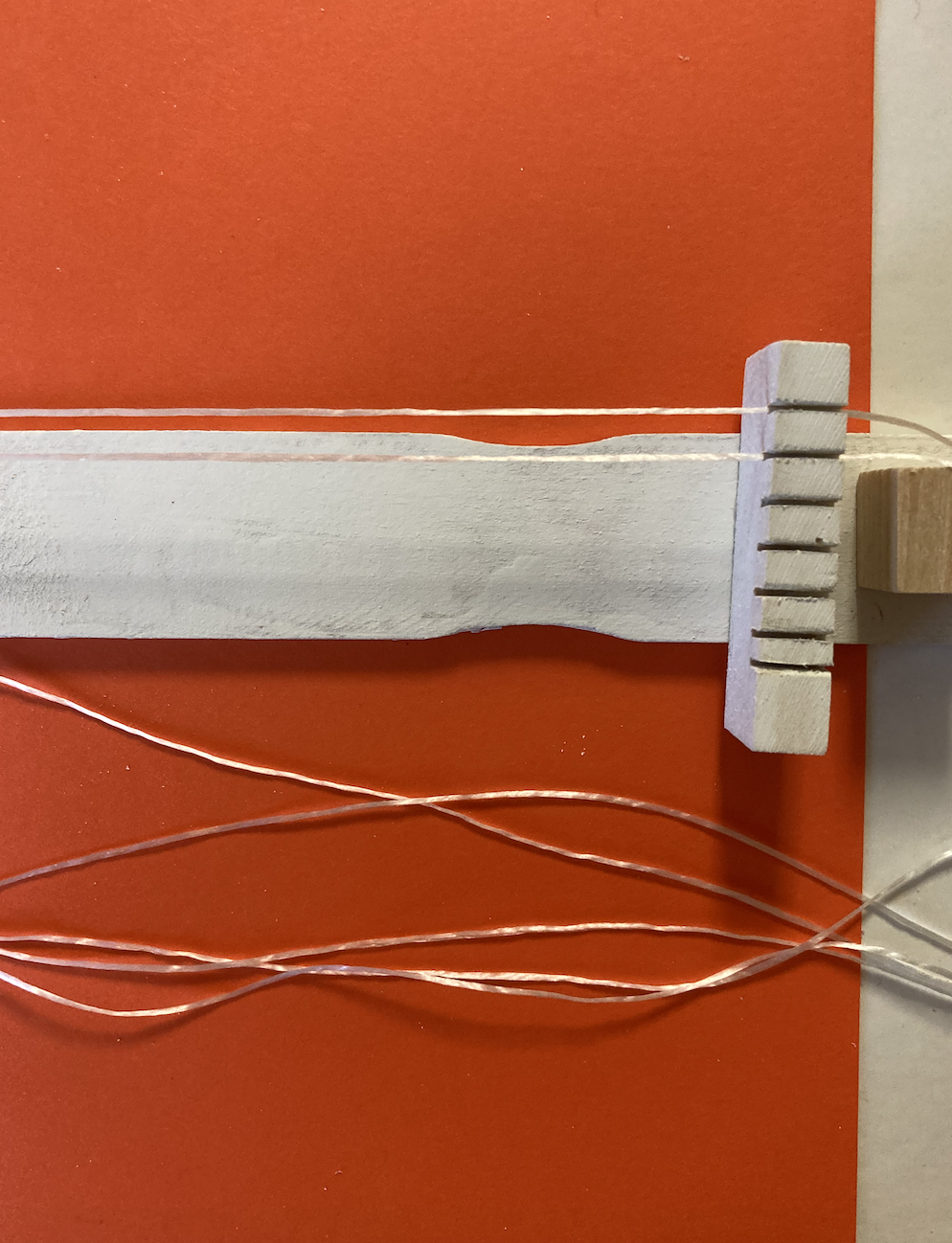

Step 5: Attach the Wooden Blocks

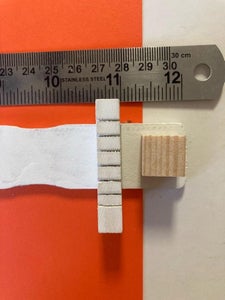

I marked 1 inch from the ends to place the tumbling blocks near the ends. Then, placed the cubes in the center of the spaces farther from the ends. At this point the tool was ready.

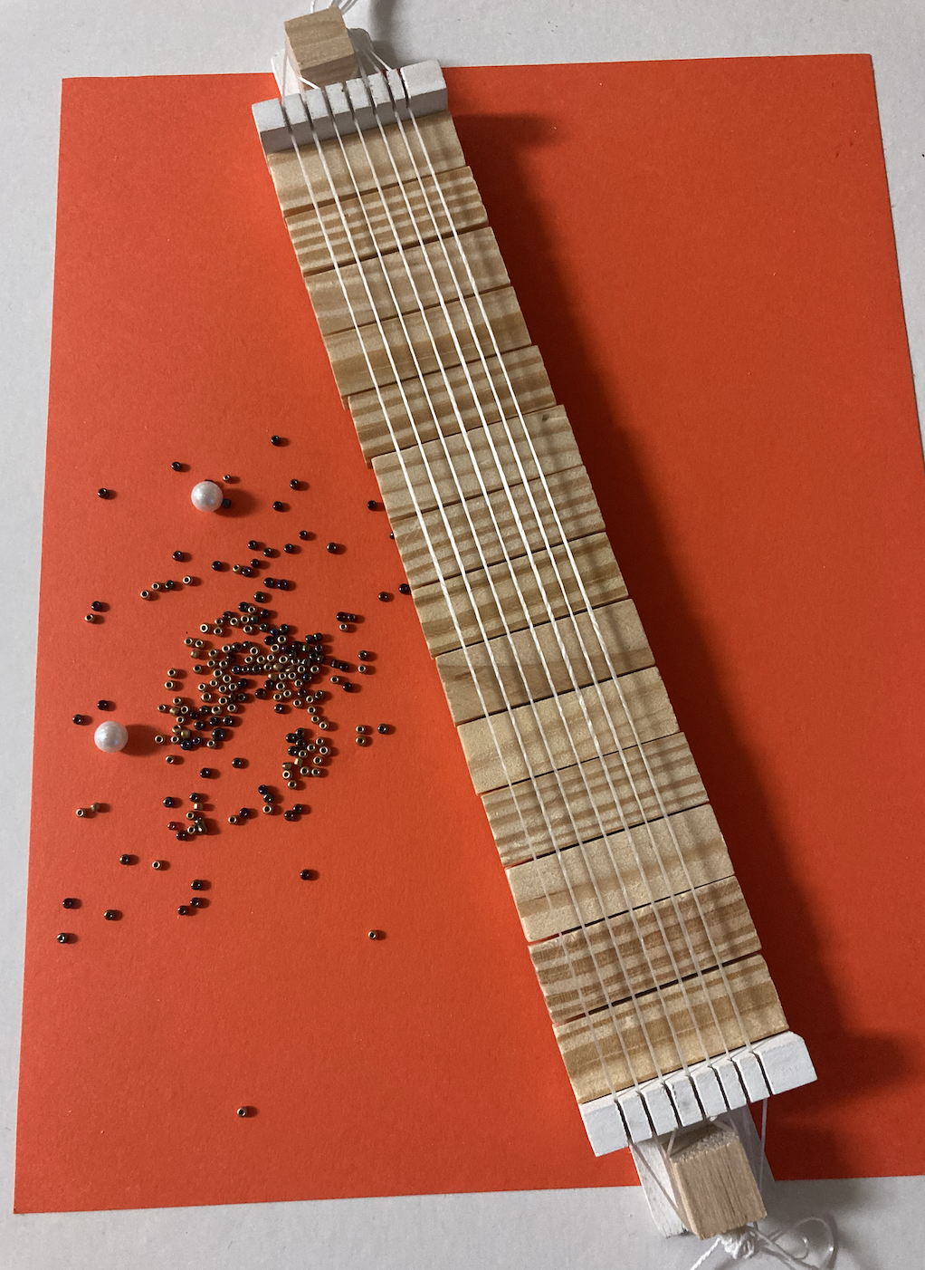

As I invited my mom to my desk to show this tool, she was surprised and happy to know how I thought of making something she'd find useful. Then, I asked her to bring the materials needed (which are the last 3 optional items on the list). As I am a novice with bead weaving bracelets, I let her try and test it carefully.

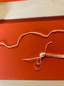

I borrowed the elastic beading thread and tied it into 7 strands. This bundle was tied on one end. Then hooked around the wooden cube and then carefully pulled throw the grooves into the corresponding grooves on the other tumbling block. This created amazing strands and to me, this looks like a guitar :-) My next inspiration.
She tried to insert the beads in the beading needle and place them under the threads. The feedback is
Features
  1. An Innovative tool
  2. Simple and easy to use
  3. The length of 1 foot is fairly good
Tips
  1. The number of strands = The number of beads in a row + 1 (which means this tool could be used to make a max of 6 beaded rows
  2. The grooves have to be closer (or at the distance of the bead size) The beads that my mom has are smaller :-)
