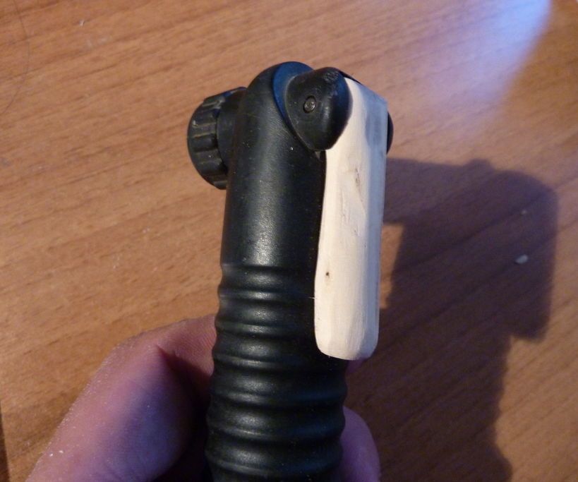

The main concept behind the DIY bicycle pegs is this: You cut a piece of a wheel axle and you screw it on a nut half way. Then you screw that nut (with the piece of axle on it) on your bicycle’s rear axle. So the nut connects the two axle. I’ve tested them standing on them, and they are very solid. If you want the passenger to stand on them you have to reinforce them by weld two nuts together so there is more thread for the connection.

Take a good thick enough piece of a stick/branch (finger thick +). Using a hacksaw cut two pieces each measuring 6-6.5cm. These will be the pegs.
Step 3: Cut Two Pieces From a Wheel Axle (same Length With the Pegs)
Do the same thing with the axle. Same length with the pegs. NOTE: Each part of the axle should have a round end (See second pic from the end).
Step 4: Drill Holes on the Two Sticks
Drill a hole through each of the Pegs. The drill bit should be a number
thinner than the axle. TIP: Drill half the distance from one side and the other half from the other side. That way when you hammer down the axle inside the peg, the wood won’t split easily.
Step 5: Using a File Make the Hole at the Right Size
Make the hole bigger with the file. It should be big enough for the
axle to be hammered inside the axle. It should fit very snuggly. NOTE: The round end of the axle piece should be outside and half a CM out of the peg (a half nut). If the axle doesn’t move when you hammer it inside the peg, take it out and make the hole a tad bigger.
.Step 6: Screw on the Nut
Take a nut and screw it tighly on the axle end. That’s it! Now you can screw it on your bike!
