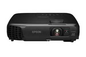

One of the things I knew had to be done was to protect the projector, from wind, from rain and since I was using it in the winter from snow. It was no easy task. I had to have the projector protected but because it puts off a lot of heat I also had to have it so airflow was not a concern.
This project only required a few on hand materials and a few screws to complete.

  1. Remove the top of the plastic tub or bucket that you will be using
  2. using your wooden serving tray attach the bucket to the top of the tray leaving about a 4 inch gap in the back for air flow using 1" wood screws
  3. put it where you will need to run your projector make sure it's level
  4. Place the projector inside and install the plastic or glass panel on the inside of the bucket
  5. you can run the cords needed for your projector through the gap in the back.
  6. project your favorite videos or holiday images onto your house
