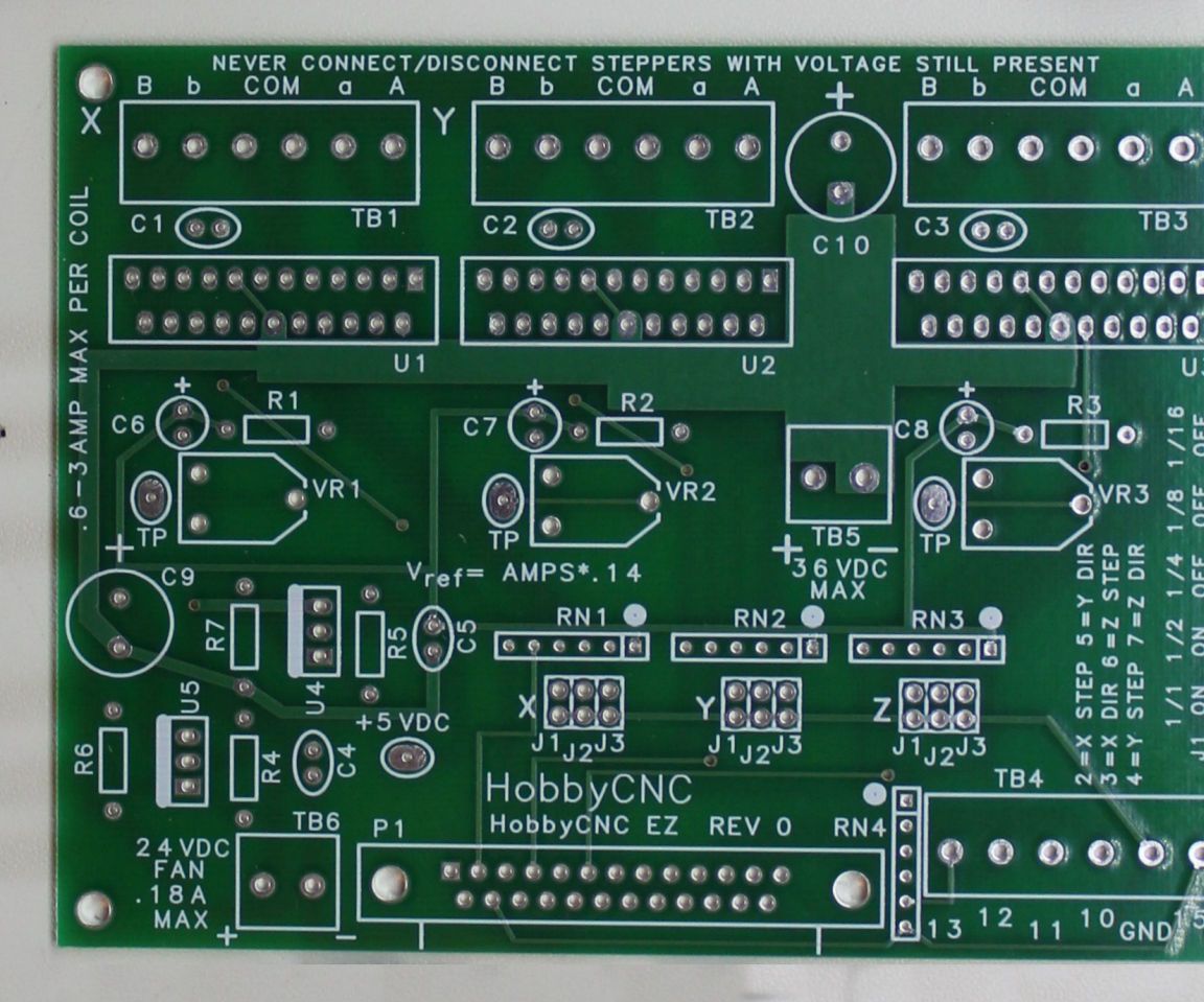

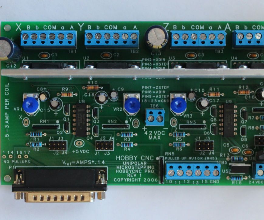

Stepper motor driver
I recommend to "keep it simple". I use and recommend the HobbyCNC board. One board, up to 4 axis. No break-out board and much simplified wiring and a much smaller footprint. Whatever you do, avoid eBay foreign-made driver boards. You want to be a CAD CAM expert, not a "fix the cheap import" expert.
You need a parallel cable with all pins wired straight through.
If you must use USB or Ethernet there are solutions (price goes up quite a bit, though).
