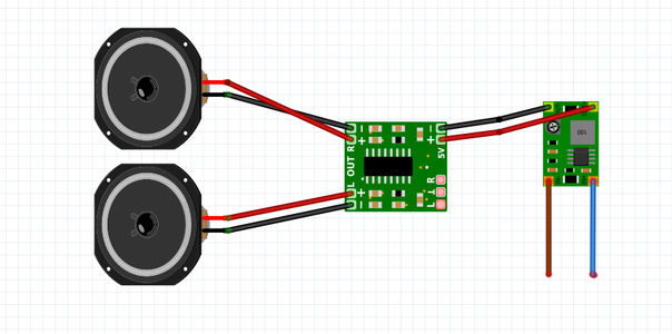

o make the schematic easy to understand I'm gonna break it up into few segments
Speakers + PAM 8403 – solder 4 (2+2) wires on PAM8403 amplifier board (output) + and -. Then solder two wires on the right speaker and then two on the left speaker. And that is it for speakers. Because I used a 12v Bluetooth decoder board to power the PAM8403 amplifier I needed to step the voltage down to 5v, that is where the buck converter comes in. IMPORTANT NOTE: BEFORE SOLDERING BUCK CONVERTER ONTO PAM8403 BOARD FIRST SET IT UP ON 5V, SO AMP WOULDNT BLOW UP. On the PAM8403 board, there are L, R, and GND contacts ( GND on this board is reversed T ), 5 wires are coming out of the Bluetooth decoder board (6 if the antenna is included) 3 of those wires are R, L, and GND, Connect those 3 wires to amplifier board accordingly. ( They are marked on both boards so it really isn't hard.). And 2 leftover wires (usually red and black) are + and – and they are going onto Li-ion battery pack. For radio to work you may need to additionally solder wire on the decoder board to act as an antenna. And regarding the Li-ion battery pack, those BMS boards are usually marked where to connect batteries, so follow those instructions and that should work fine. I replaced batteries later in the build, regarding photos in this step batteries were blue and there were two cells, in the finished version of this build I replace them with three cells and 12,6 volts BMS board (green color), don't get confused there.
