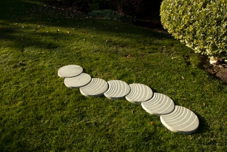

Step 6: Placing Stepping Stones
  • Stepping Stones are good for transitional spaces in the garden and for areas that get muddy.
  • They can simply be placed on or planted into the ground for a snug fit.

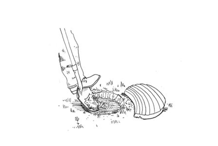

  • To plant into the ground, place the stone where you want it, and sprinkle flour along the border to mark the location. Dig a hole 3-4" deep and fill it with 2" of sand. Place the stepping stone in the hole and rock it back and forth until it's fully seated.
