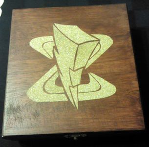

Step 6: Final Touches
- Install an Eye-Screw (wood screw bottom, and eye hook top) on the lid and base approx 1" to 1-1/2" from the hinge space as shown.
- Adjust you chain to an appropriate length to hold the box mostly open and install it in place.
- Add some flair to the lid of the box, I have included an image I designed for my morpher box along with a stencil.
- Cut the design out from fancy paper and glue the pattern in place with glue all.
- Place the insert back in the box and put you collectables inside and you are finished! :)
