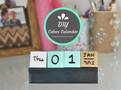

Step 3:
Decide the color scheme of the cubes. My current faves are teal ,gold ,black and white but you can chose your own favorite color scheme or go with mine. Paint the cubes in the colors you picked. I went with teal for date cubes, white for days cube and gold for months.Two to three coating will be perfect to mask the wood from showing through.
Step 4:
Now to the making of stand for cubes.I made this stand by trail and error method.With cubes measurement as key I started building the stand. You can pretty much make this stand for whatever size of cube you have. My cubes measured 1.4".So, if you also have the same cube measurement, then You will need
2 card boards(Middle) -- 6" x 1.4"
1 card board (Front) -- 6" x 1"
1 card board (Back) -- 6" x 2.6"
1 card board (Base) -- 6" x 2.4"
Glue the cardboard as shown in the images.Refer the image notes for more detailed instructions of each step in making of the base stand.
Glue the middle cardboards together.Then attach the front and back followed by the base.
Step 5:
Once you are done building the base , trace the sides on to the cardboard and cut them. Glue them to the sides using glue gun. Your cardboard base is now ready.
Step 6:
Cover your stand with black card stock and mod podge. Use the base that you have just build as a template and trace around black cardstock leaving 1/2 inch extra on all sides .Cut it and use mod podge to glue it to the cardboard. Once the glue is dry , use another coat of mod podge above the card stock to give a polished look. Your base is now ready. If you feel that is too much of work,cover it with paint.
Step 7:
Once the wood blocks are dry. Write the date, day and months with pencil and then go over them with the paint pen for the final touch. If you are confident enough you can write directly with paint pen.Finish it with a coat of sealant like triple gloss paint or clear gloss spray paint.And then, you are done!Cube 1 (Day) - Mon, Tue, Wed, Thu, Fri. Sat/SunCube 2(Date) - 1,2,3,4,5,6Cube 3(Date) - 0,1,2,7,8,9Cube 4(Months) - Jan/Jul , Feb/Aug ,Mar/Sep , Apr/Oct , May/Nov , Jun/Dec
