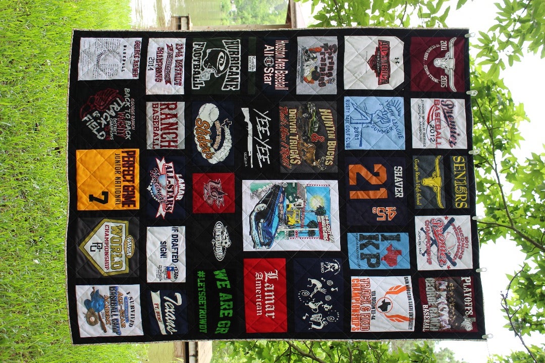

Custom T-Shirt Quilt Top - Variable Style With 1.5" Sashing and 2" Border
8,447
56
10
Introduction: Custom T-Shirt Quilt Top - Variable Style With 1.5" Sashing and 2" Border
The sample used in this Instructable is for a throw size quilt. However, the process can be applied to any size quilt.

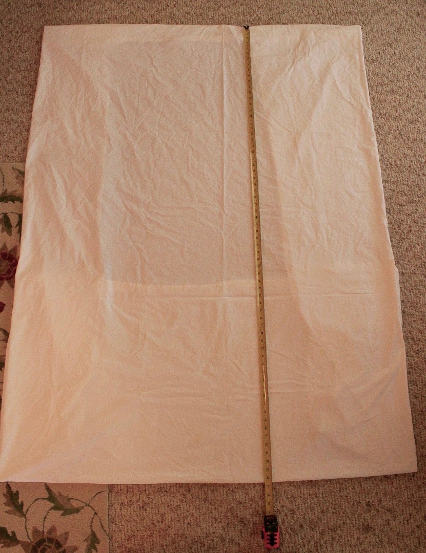

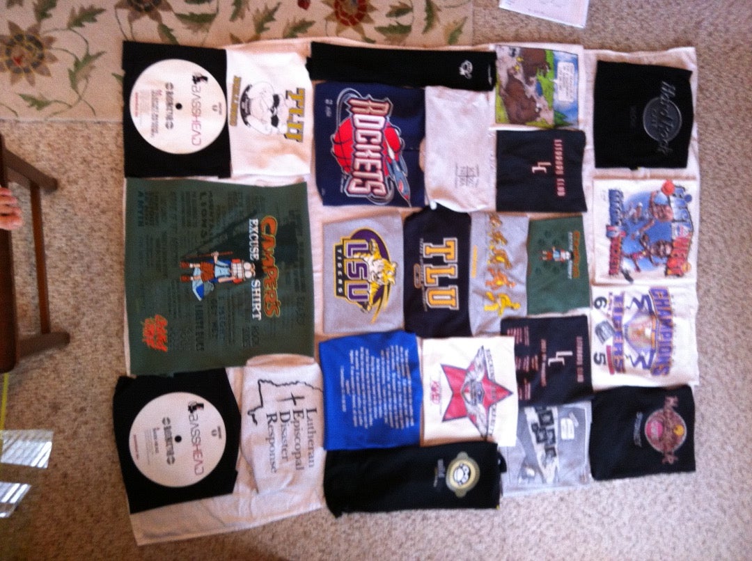

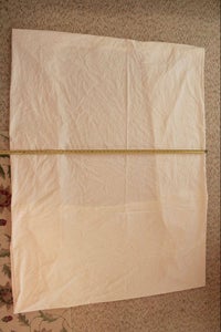

Step 2: Preliminary Layout and Shirt Preparation
1. Cut each shirt apart staying as close as you can to the seams at the sides, arm holes and neckline.
2. Place a sheet on the floor and fold the edges under to the reduced size, i.e., the size calculated for quilt top not including the borders.
3. Fold the shirts under at the edges and lay them out on the sheet as you would like them to appear in the quilt top (staying at or near the sheet edges as much as possible since the sheet has been pre-folded to the desired size - see photo). Keep in mind these quilts are sewn in sections, so start arranging with the area containing the most shirts. In the sample, the most condensed group of shirts are in Section 1 (the entire area between the long black shirts with the monkey emblems on either side). Because Section 1 contains the most shirts, it will be the most challenging one to keep within the desired width and length, so I'll want to sew it first.
TIP: Keep color balance (darks / lights) and intensity of emblems (busy / not busy) in mind when you lay the shirts out. Try to alternate darks / lights and busy / not busy as much as possible. It's worth the time to try several different layouts and take a picture of each with your phone (you'll have to stand on a step ladder or chair to do this because you want to be high enough to capture the overall design). Scrolling through the photos offers a quick visual comparison, and a picture really is worth a thousand words -- you'd be surprised at the clarity this offers for layout selection.

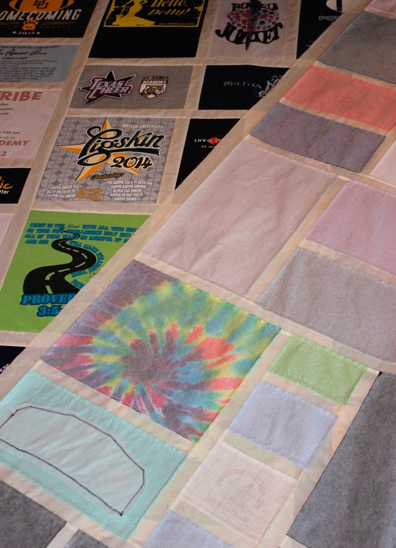

3. Apply interfacing to each shirt in accordance with the product instructions. Make sure each piece of interfacing is large enough to cover the entire back of each block after it's cut to block size. It may seem wasteful, but it's better to cut the interfacing too large than discover, when you trim the shirts to the proper size, that the interfacing doesn't make it all the way to the edges. After applying interfacing, refold and replace each shirt on the sheet back in the desired layout.
TIP: For applying interfacing, heat iron to "cotton". Place a towel or other protective fabric over your ironing board. From the shirt remnants you do not plan to use, get the largest piece (with no emblem on it), and use it as the press cloth (place it over the interfacing being careful not to wrinkle the interfacing). A setting higher than "cotton" may melt t-shirt designs, and even a cotton setting will ruin synthetic fabrics upon direct contact.
TIP: Interfacing, like t-shirts stretches one way more than the other. T-shirts stretch more widthwise. Interfacing should be placed so that the maximum stretch is lengthwise (the opposite of the shirt -- the goal is to not have both easily stretching in the same direction)

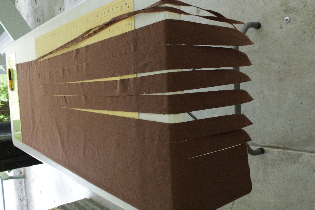

Step 3: Quick Way to Prepare and Cut Sashing and Border Strips
I like to cut sashing and border fabric lengthwise rather than along the width of the fabric for two primary reasons:
  1. Because it gives sashing strips and borders a cleaner look (not pieced)
  2. Because I find it easier and quicker to cut multiple strips at one time
For the sample quilt, I know the finished length will be approximately 72.5". I want to have a lengthwise piece of fabric that allows a few extra inches, so 2 1/4 yards of fabric will be needed. If you're economizing or don't think you'll use the leftovers, you may choose to cut sashing and borders from the width of the fabric -- you'll use less that way.
TIP: I like solid or tone-on-tone sashing and border fabrics for t-shirt quilts. Prints tend to compete with the shirt designs.
  1. Prewash and dry the fabric
  2. Iron it (starch makes cutting easier and more precise)
  3. "Square" the fabric. Here's a link to a You Tube video showing how to do this. In the video, the fabric is only a small piece, but the same thing can be done with a longer piece holding the center and letting the ends hang. Once I've squared the fabric, I do press the fold (the video doesn't say to do this). It makes it easier to hold in place while cutting long strips.
Lay the fabric on the cutting mat lengthwise, and cut strips in sections as you go, i.e.:
  • Trim the raw edges of both layers along with width of the fabric up to the edge of the mat
  • Cut the 2 strips at 2.5" for the four borders of the quilt up to the edge of the mat
  • Depending on the size of your project, cut a few more strips at 2" to use for sashing (between blocks)
  • Slide the lengthwise fabric down to the uncut portion and repeat the two steps above until you have a few strips cut the entire length of the fabric (see photo)
  • Hanging the strips and leftover piece over a coat hanger and labeling them prevents me from accidentally grabbing the wrong size (see photo)

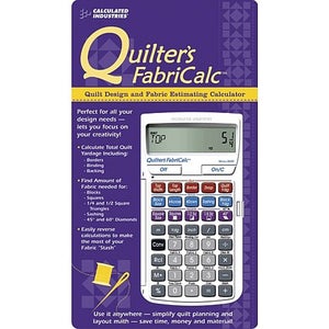

TIP: It helps to have a Quilter's FabriCalc (see picture) because it quickly converts from decimals to fractions and back again. Of course, if you're really good at math, you may not need this! The decimals are handy for writing out a diagram, while the fractions make cutting the fabric (using the quilting rulers) easier.

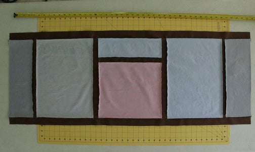

Referencing your diagram cutting measurements, cut and sew Section 1, which should be the section that contains the most shirts and has the most complex design.
The attached Diagram 1 labeled "Sewing Sequence" shows the order in which I pieced the sample quilt top.
TIP: I sew variable style quilts starting in the middle of each section and work my way outward on either side. As stated earlier, 1/4" seams are difficult to maintain consistently because shirt textures and thicknesses vary. I sew the middle and work my way outward, using a tape measure and side-by-side comparisons of rows to determine if I need to add or subtract a fraction of an inch. This way any correction can be made in a balanced portion and inconspicuously on the outer blocks.
TIP: It's almost impossible to use too many pins when piecing blocks and sewing sashing. Always pin the outer edges first, then the middle and work outward, pinning about every 3". Doing so will make your blocks match perfectly and prevent tugged fabric and misaligned seams.
Here are details of the steps for the sample quilt referenced in this Instructable. Of course, every custom project is completely different, but this information is provided in order to show a sample of the logical progression of block and section assembly. It's done in such a way that the sashing strips are as long as they can be, i.e., they are continuous strips and do not have extra seams:
Section 1:
  • Cut and sew 2" sashing strips to the bottom of blocks 1 and 2 (all sashing is from the 2" strips previously cut -- recall that the 2.5" strips are border strips for around the edge of the quilt and are applied last)
  • Press all seams toward sashing being careful not to touch iron on any synthetic fabric or shirt emblems (hereinafter this process is noted as "press")
  • Sew blocks 1, 2 and 3 together; press
  • Cut and sew sashing on both sides of pieced blocks 1, 2, and 3; press
  • Cut and sew sashing to the bottom of blocks 4 and 6; press
  • Cut block 5, and sew blocks 4 and 5 together; cut block 7 and sew blocks 6 and 7 together; press
  • Cut and sew sashing to the left side of blocks 4 and 5 and to the right side of blocks 6 and 7; press
  • Sew blocks 4 and 5 to the left side of the middle section (blocks 1, 2 and 3); sew blocks 6 and 7 to the right side of the middle section (blocks 1, 2 and 3)
  • Measure for desired width and make allowances if necessary when cutting blocks 8 and 9
  • Sew remaining blocks (8 and 9) as shown on Sewing Sequence Diagram 1; press
  • Cut and sew a strip of sashing across the top of Section 1; press
  • This completes Section 1.

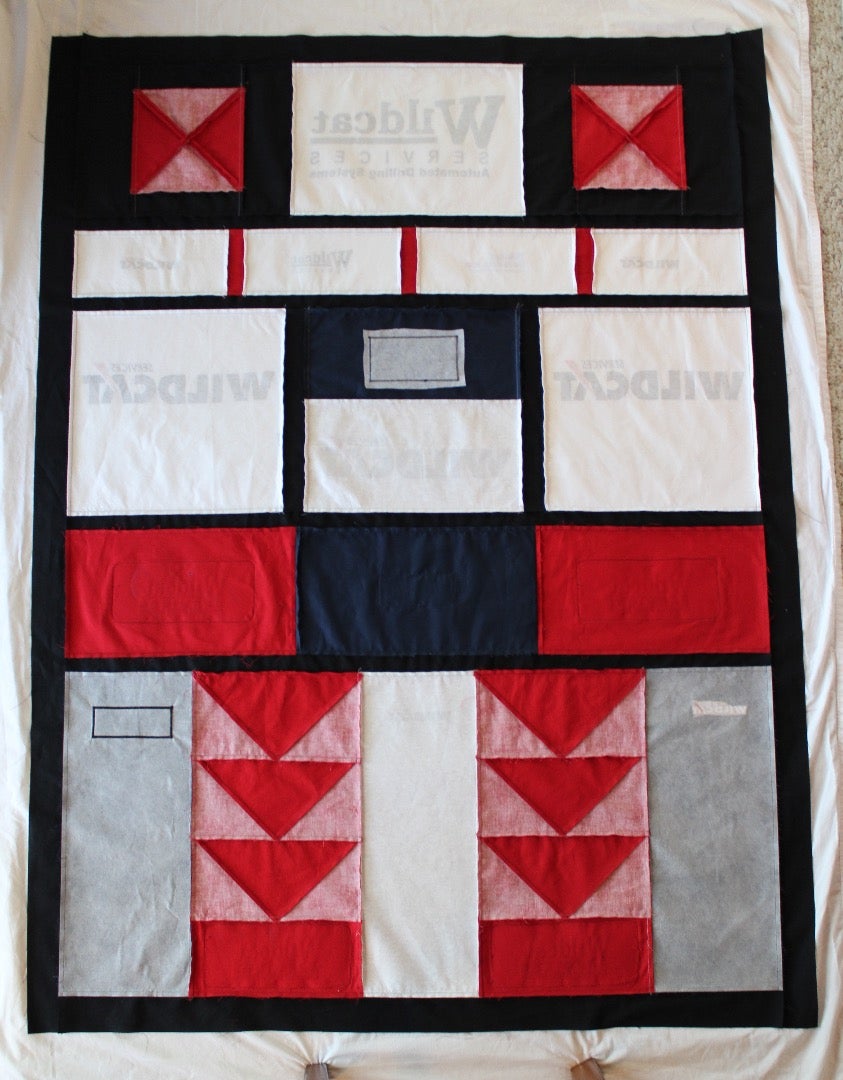

Sew Sections 1, 2, 3 and 4 together as shown on Sewing Sequence Diagram 1:
  • To keep the quilt uniform when joining Sections, align Sections (right sides together) and pin together at either end, then the middle, flattening the fabric as you progress; continue pinning from the center outward, approximately 3" apart to ensure the finished product is properly aligned.
  • Sew Sections 1 and 2 together, then 3 and 4. Then complete the piecing portion of this project by sewing the top two Sections to the bottom 2 Sections as shown on Sewing Sequence Diagram 1.
Border:
  • Place the quilt top back on the sheet / floor. Trim one end of all 4 of the 2.5" border strips. Place 2 of the border strips across the entire middle of the width of the quilt (be careful to keep trimmed ends together and align the trimmed ends with the left side of the quilt top), measure the middle width to confirm it's what you anticipated (it should be very close, especially if you pressed as you sewed). With a quilting ruler, evenly mark the 2 border strips at the right edge and cut with scissors or rotary cutter.
  • Pin and sew the top and bottom borders to the quilt top. Again, pin each of the corners, then the middle and outward on either side, pinning about 3" apart for stability. Press seams towards the border.
  • Place the quilt top back on the sheet / floor. Repeat the above process for the lengthwise borders, placing the remaining two 2.5" border strips over the quilt top in the middle of the length of the quilt, measure, mark, cut, pin and sew the side borders.
