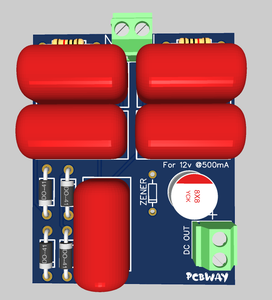

Step 5: PCB Designs:
1st PCB design has 5 capacitors of 1uf, because it needs high current on output. And the 2nd one in which voltage is higher than current requirement need only one capacitor all the calculations for voltage and current are explained below.
1st image: For 12v @500mA
2nd image: For 60v @12mA
If you want to use the same design then download the Gerber files from here, you can directly use these designs to order the PCB from PCBWAY. PCBWAY provides a huge range of prototyping like PCB fabrication, PCBA, SMT assembly, 3D printing, Metal CNC, Stencil and lot more. You can order 10Pcs of 2-layer PCB in just $5.
