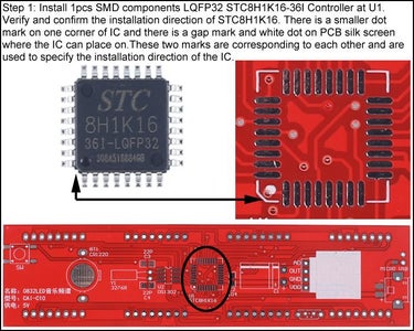

Step 1: 1 Pc SMD Components LQEP32 STC8HK16-36I Comtroller at U1
Please following the instruction
Step 2: Melt the Solder
Step 3: Fix STC8H1K16

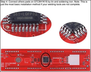

Step 4: Connect Other Pads on STC8H1K16

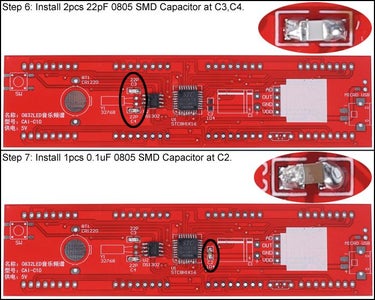

Step 6: 2 Pcs 22pF 0805 SMD Capacitor at C3 C4 1 Pc 0.1uF 0805 SMD Capacitor at C2

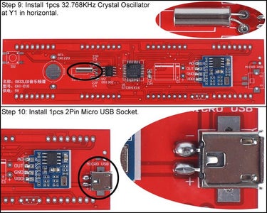

Step 8: 1 Pc 32.768KHz Crystal Oscillator at Y1 1 Pc 2 Pin Micro USB Socket

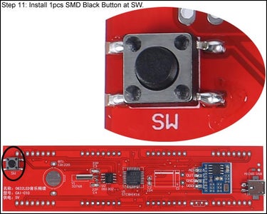

Step 9: 1 Pc SMD Black Button at SW

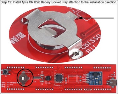

Step 10: 1 Pc CR1220 Battery Socket

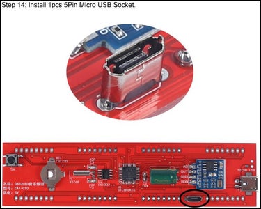

Step 12: 1 Pc 5 Pin Micro USB Socket

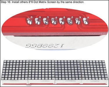

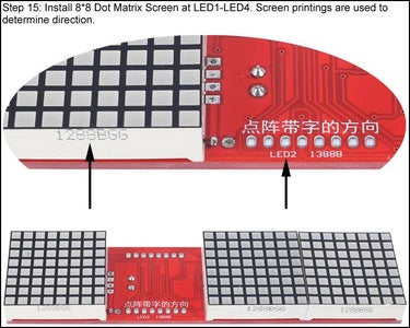

Step 13: 8*8 Dot Matrix Screen at LED1-LED4
Step 14: Other 8*8 Dot Matrix Screen

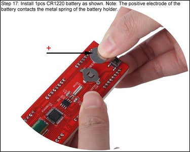

Step 15: 1 Pc CR1220 Battery
