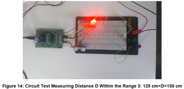

To test the design, the configuration used on the emulation tool provided by the software can be seen in Figure 6. The connections on the pins of the emulation software can be seen after it on Table 2.
The emulation tests show that the design works as expected by providing an interface system to interact with the ultrasonic sensor. The emulation tool provided by GreenPAK proved itself a great simulation tool to test the design logic without programming the chip and a good environment to integrate the development process.
The circuit tests were made using an external 5 V source (also designed and developed by the author) in order to provide the nominal sensor voltage. Figure 7 shows the external source used (020 V external source).
To test the circuit, the echo output from the sensor was connected on the input of PIN2 and the trigger input was connected on PIN4. With that connection, we could test the circuit for each one of the ranges of distance specified on Table 1 and the results were as follows in Figure 8, Figure 9, Figure 10, Figure 11, Figure 12, Figure 13, Figure 14, Figure 15 and Figure 16.
The results prove that the circuit works as expected, and the GreenPAK module is capable of acting as the interface for the ultrasonic distance sensor. From the tests, the circuit designed could use the state machine and the internal components to generate the required trigger pulse and classify the returning echo lag into the categories specified (with 25 cm steps). These measurements were made with the system online, measuring every 100 ms (10 times per second), showing that the circuit works well for continuous distance measuring applications, such as car parking assisting devices and so on.
