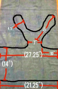

Step 2: Measure Your Dog
1. Measure the circumference of your dog at place 1 and 2 using a sewing tape measure.
2. Measure the distance between the front and rear legs of your dog
Here are my dogs measurements:
1 - 29"
2 - 23"
3 - 14"
3. Subtract 1.75" from measurements 1 and 2.
Final measurements are:
1 - 27.25"
2 - 21.25"
3 - 14"
Step 3: Cut the Fabric
The picture shows the dimensions that I used. The three measurements that you took are in parenthesis. Remember to adjust all dimensions in order to fit your dog.

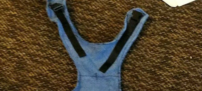

Step 4: Sew Around the Edges
Sew a 1/4" seam all the way around. To make it easier you can iron the edges. Place it on your dog to ensure it fits properly. Make any adjustments. I had to cut down the lengths of the "y" because it was too long.

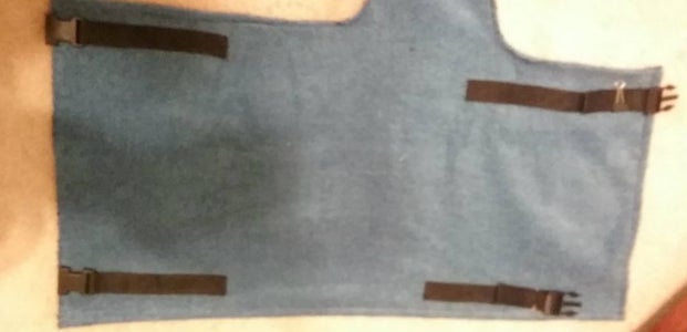

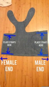

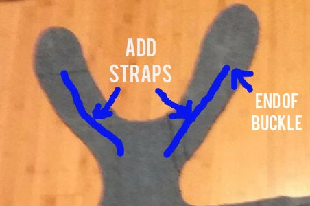

Step 5: Cutting the Straps and Sewing Them in Place
Cut the 4 straps about 8" from the male end of the buckle. Cut 4 12" pieces from the remaining strap. Burn the ends to stop the strap from fraying. Only sew about 6" of the female end of the buckle. Leaving 6" for adjusting the harness. Sew an "X" into the strap at both ends for extra strength.

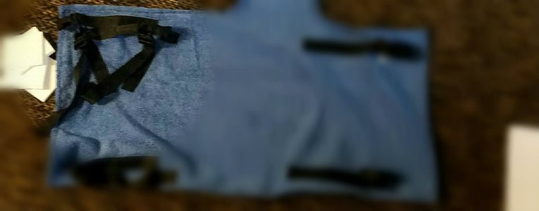

Step 7: Place It on Your Dog
You may have to make minor adjustments to get it to fit perfectly. Great job and enjoy your DIY mobility dog harness.
