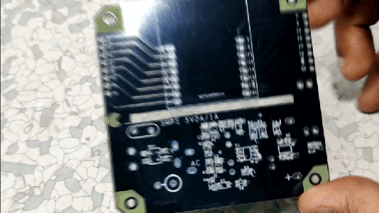

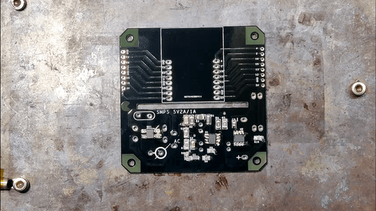

Anyways, to get started with this project, I first designed a charger circuit by replicating and reverse engineering an existing 5V 1A Charger circuit that I found in an existing commercial mobile phone charger. (SCHEMATIC IS ATTACHED)

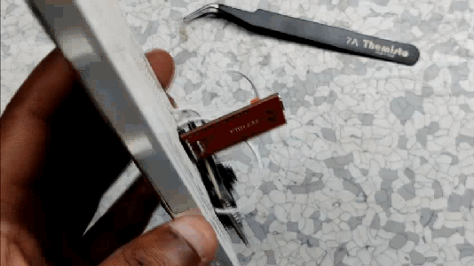

Now, this project involves working with the AC supply which is pretty lethal so I don't recommend you guys to replicate this project as I did, instead of making an SMPS CIrcuit, you can use an isolated power supply module to power this board. it's still dangerous but it will decrease the chances of getting elecuted by this project.
To use the isolated power supply, I have already added its Pads on the PCB so we can just solder this onto the circuit or use an extremely dangerous non-isolated charger circuit.

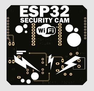

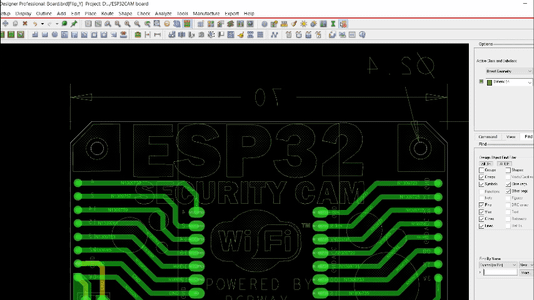

I designed this whole project in my OrCAD software, I wanted to add a custom silkscreen to this board so I prepared this image in GIMP and then exported the PNG image.
then I converted the PNG file into a BMP (because the OrCAD only imports BMP Images) and then added this image onto my PCB design and this was the result! note- this method will be different for every PCB Designing suit so just follow your PCB Cad software image importing process and you'll be good.

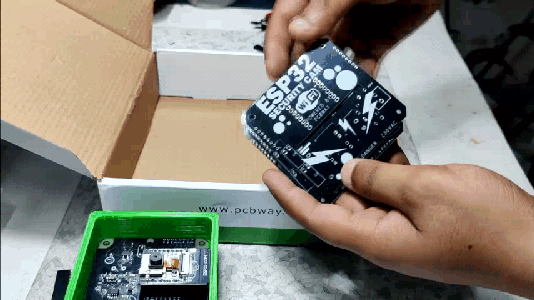

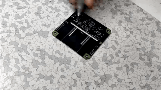

Step 3: Getting PCB Made From PCBWay

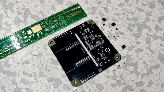

After finalizing the PCB, I exported its Gerber data ad send that to PCBWay for samples,
I received the PCBs in a week, PCB quilty was pretty great and I'm happy with it. PCBWay you guys rock, Check out PCBWay for getting great PCB Service at less cost!

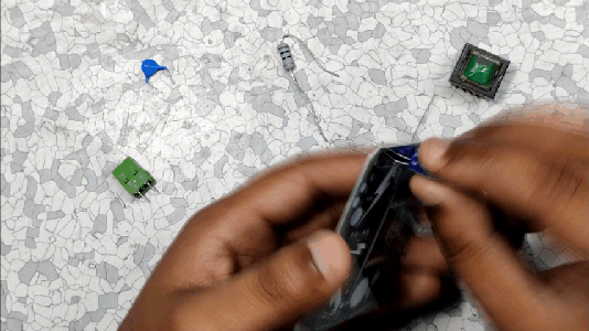

Step 4: Assembly Process

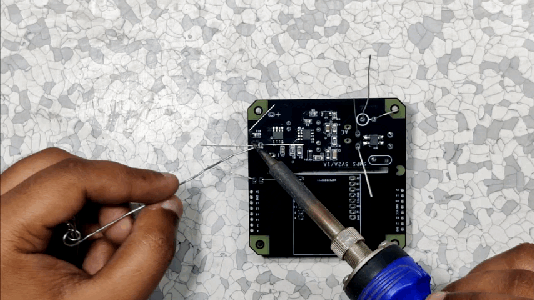

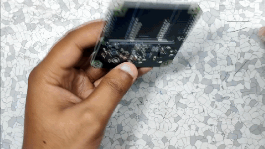

After receiving the PCBs, I started the assembly process of this board.
  • We first add solder paste to each component's pad one by one. (a better alternative is to use a stencil which I didn't get because I'm such a genius 🤡)
  • After this, I added components to their assigned place one by one in the right order and then after doing that, I verify the board one last time, and then I put the whole circuit onto my DIY SMT Hotplate for the reflow process.
  • Solder paste will melt as soon as the reflow surface hit the solder paste melting temp and then we carefully remove the PCB from the hotplate and let it cool down for a little bit.
  • after checking the PCB solder joints and making sure that we didn't short any components, we then move on to the next step which is to add THT components like the capacitors, fuse, MOV, and transformer.

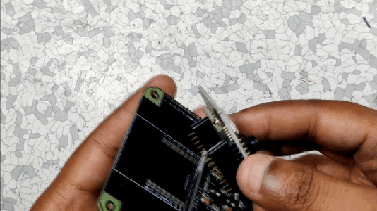

  • After adding these components, I added a female header pin to connect esp32 with this board, and our circuit is finally ready for its first test.
but before that, I added the circuit on ts 3D Printed body and then added an AC Cord to the input of the PCB to supply 240V AC t this setup.

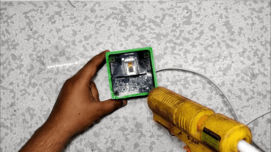

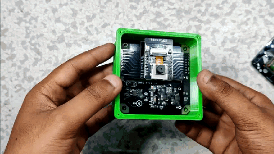

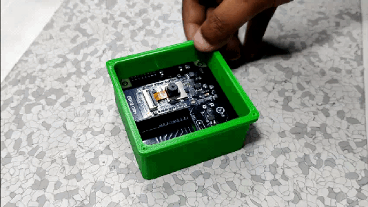

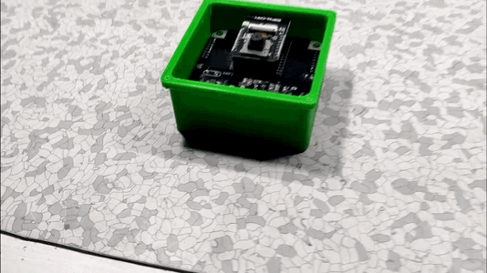

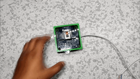

Step 6: 3D Printed Enclosure
I prepared its body in fusion 360 and then 3D Printed it with PLA, yes I know, I should've used a better material that can withstand the outside heat as PLA will start deforming at 160°C, and here at my place, the outside temp is around 35-40 outside so the PLA might melt and that's one flaw.
well, that's a gamble that I took so maybe it will not melt, we will see how that goes. I've already flashed the ESP32 with the ESP32 CAM webserver sketch and I already have its IP address.
https://www.instructables.com/ESP32-CAM-WEB-Server-and-Getting-Started-Guide/

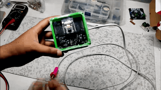

so we just need to make sure first that the ESP32 is fed with a 5V supply and for that, I checked the Voltage on ESP32's VCC and GND Port.
Now, at last, I added this acrylic transparent sheet on the first side of the enclosure with screws and hot glue, hot glue will create a gasket in between the acrylic transparent sheet and 3D Printed Body which will hopefully protect the inside from moisture content.

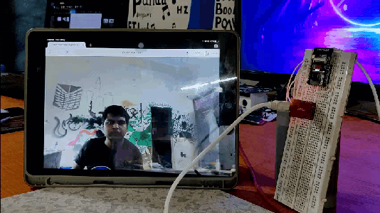

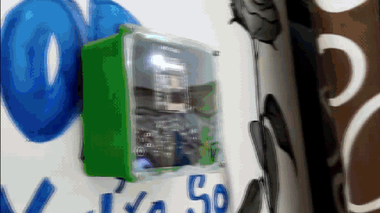

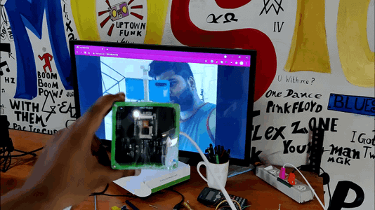

Step 7: RESULT
After finalizing this whole project, I placed oy outside my room and plugged the AC Supply into it.
To monitor the live feed, we can just go to the ESP32 CAM IP address and view the live feed.
And that is how you can save so many bucks or rupees in my case by not purchase an actual security cam and DIY this whole thing for less than 15$ or 1100 Rupees. Leave a comment if you need any help with this project!
