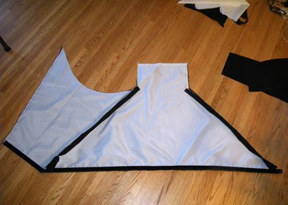

Step 4: Mate the Black & White Nylon Panels
If you can find a black nylon with white on the inside this step won't be necessary. I've seen some outdoors fabrics that have this, but not in a black (yet).
I ran a seam down the middle, then worked my way out from there. You might consider pinning the two pieces together so that they don't slip as you sew them together.
Also, at the bottom of the panels I added a velcro strip while finishing the edge - this will be used to attach the white diffusion panel in the very last step.
Step 5: Piece It Together One Seam at a Time
As shown in the images, join the pieces together. When joining the Side to the Front/Back panel, use a strip of nylon (I used black, but would suggest using white if you have it) to create a 'tunnel' to later guide the tent pole. At the bottom of this tunnel, I added a heavy duty 2" wide piece of webbing (melt ends so they don't fray) - as this is one of the places that will get the most wear (accepting the end of the pole).
