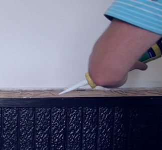

Step 5: Attach the Sleeper
You'll most likely need to strip the existing mantel if it's timber. To this a heat gun works really well, or you can sand/chisel some gouges into the wood. All you're looking for here is some bare timber for the glue to adhere too.
Liberally apply glue to both the existing mantel AND the sleeper to ensure good coverage. I find it best to make some pools of glue to ensure good contact. Spreading a film work great if both surfaces are flat and square but this will most probably not be. This is why we're using construction adhesive in the first place.
Remember, you aren't clamping the sleeper to the fireplace, it's glued onto the existing mantel. I used a 2x4 to spread the pressure along the entire sleeper. I also drove a couple screws through the sleeper into the existing mantel as an added clamp, but the glue will do most of the work.
