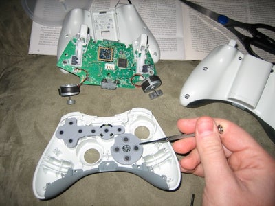

Step 1: Open and Dissasemble the Controller (security Bits Not Required)

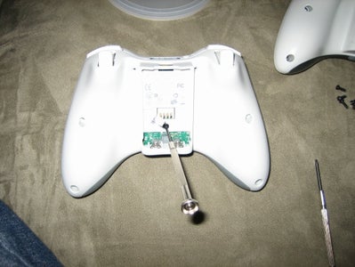

Open the controller (there are lots of pictures on-line) The hardest thing for me was realizing there's a screw under the sticker under the battery pack. (Opening and breaking this sticker probably voids your warranty). On the wireless controller there 7 screws in total.
You need a Torx-9, but I didn't need a security bit to open the screws. Instead I inserted a small screwdriver and twisted until the security nub broke clean off (allowing the T-9 to fit perfectly).
The back sort of pops off from the top. Pull straight out, to avoid damaging the battery contacts that hang off the main board and slide into the controller back. Also, it helps to hold down the triggers.
Try to keep the controller face down when opening. This will keep the buttons from spilling out every where until you are ready for them.

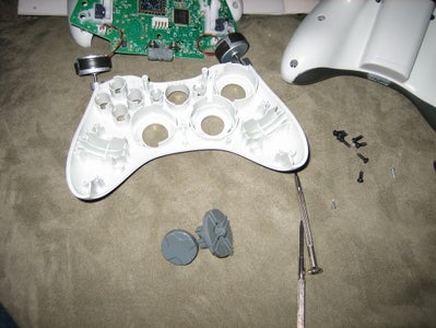

With the back off, remove the main board -- I found applying light pressure to the analog pads helped. Notice the rumble motors are just sitting in the wells and are attached to the main board by jumpers. Leave them plugged in but move the board carefully (don't let them hang and stress the connection point).
Now, flip over the top and knock out all the buttons. Don't lose them! Also, don't worry, they are keyed, so they only fit in the correct holes and only fit so they are oriented the correct way.

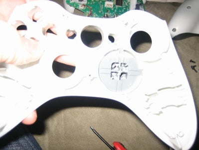

Lastly, you need to get the D-Pad mechanism out. Unscrew the two small screws shown and gently apply pressure to each of the clips in the D-pad mechanism.

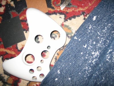

Step 2: Sanding Out the Outer Well

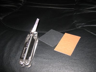

Here we're going to sand out the outer well to add more room for the d-pad to move.
The picture of two controllers shows about how much sanding you should do by showing a before and after controller (look at the wall around the D-pad -- the top has already been sanded).
Don't worry about sanding too much, but do be careful not to remove anything from the inner circle or sand down. You're just sanding out and around. There are lots of tutorials and instructables about sanding, so I won't go into it too much here. I found it easier to carve out the space with a leatherman filing attachment and then go back in and sand with about 300 grit. Took me very little time. I also found it easier to move the controller while I kept the leatherman still, but whatever. This part isn't exactly a science.

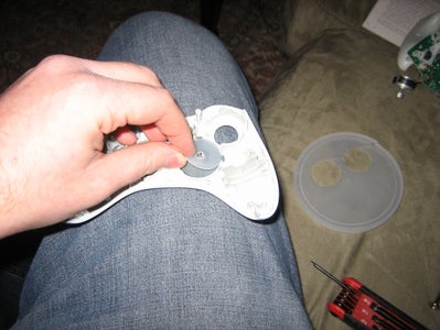

Step 3: Creating the "gap" Spacer
Now that the sanding is done, the d-pad is even more likely to slide around (which is bad). What we want to do is fill up a little bit of the slack inside the pad. We'll insert a small, thin piece of plastic into the well so that when the controller is closed, the d-pad won't be able to slide around or move without pressing the membrane (the side effect of the increased pressure is that the membrane will also feel like it's kicking the controller back into neutral when you let go, making a pleasing clicking sound).

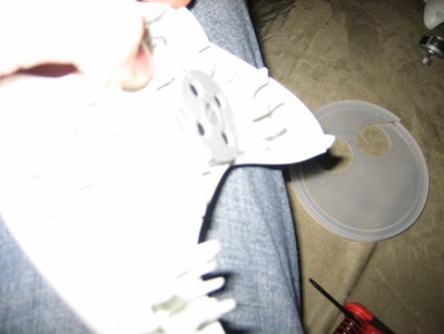

Get a pliable plastic top from a can of nuts (ideally clear) and trace the circle that's the size of the bottom of the d-pad.
Cut it out and punch a hole in the center that the pivot point on the bottom of the d-pad assembly can fit through.

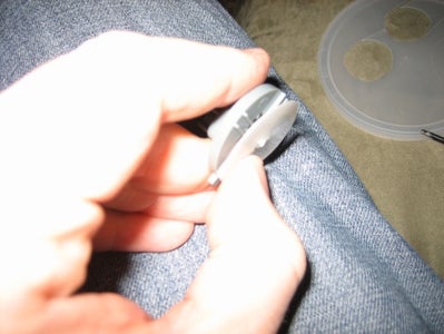

Put the d-pad assembly back into the controller housing and then put our spacer on top of the assembly.
Put the d-pad membrane on top of the spacer (it'll be snug now).
Put the rest of the buttons and membranes back in and close up shop.
