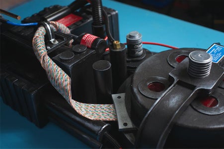

Introduction: DIY Ghostbusters Proton Pack Costume From a Foam Floormat
About: I help people make awesome costumes that are cheap to make and don't require a bunch of specialized tools. I do lots of steampunk, but others as well.
Ghosts. Nobody wants them, and there’s only one way to catch them. With an unlicensed nuclear accelerator strapped to your back, of course.
Enter the proton pack
As a child of the 80’s I grew up not thinking about the Stay Puft Marshmallow Man, and I definitely knew it would be bad to cross the streams if I ever found myself behind a neutrona wand. With the cost of a decent looking proton pack being prohibitive as well as hearing tales of sore backs from heavy packs, I decided to have a go at making one myself. Out of stuff from the hardware store. and foam. a lot of foam.
As it turns out, pretty much everything I used on this build came from my local small town hardware store or the thrift shop. The main ingredients are a 4 x 8 ft, 6-7mm thick EVA foam mat, and a lot of hot glue to hold it all together. You will also want the printable pattern from my website as well!

Step 8: Assemble the Crank Generator: Big Box
You’ll need: Pieces 2, 3, 4, 5
The crank generator is made of three sections: the big box, the little box, and the hallway. They will be made separately and then glued together.
The Big Box
Mark the dotted V groove lines on the back of piece 5. Cut the “V” grooves on the back of piece 5.
You want the V groove to go a little more than halfway through the foam without actually cutting all the way through. Start with your knife a millimetre or two to one side of the line and angle the blade towards the line. Make a couple of light cuts like this and then go to the other side of the line and repeat the process, angling the other way. You basically want the deepest, pointiest part of the groove to end up directly under the line.
If you have not done this type of cut before, I would recommend trying a few on some scrap foam until you feel comfortable with it.
Sand the back of piece 5.
Glue piece 4 onto the back of piece 5, It should fit between the V groove and the end of the piece, lining up with the outside edge.
Apply glue in the V groove as well as beside it, where the edge of piece 4 will touch.
Bend the foam into a 90 degree angle, bending at the V groove. Hold it in position until the glue is cool.
Repeat the process for the second piece 5.
Sand the back of both piece 4s that you just glued.
Mark the top of both piece 2s. Piece 2 is a little tricky because one side of it slants in towards the top, so it is important that they get glued right side up!
Sand the back of piece both piece 2s along the top.
Glue piece (4+5) to piece 2, with the shorter segment resting on the top edge. Start by gluing the corner in place, and then work your way down the sides and across the top.
Glue the other piece (4+5) on the other side of piece 2. If there is a gap in the centre top of the box, that means you've done it right!
Glue the second piece 2 on the other side, completing the box with the hole on top.
Squeeze glue along the top edge of piece 2 on both sides, just on the inside where the gap in the top is. Also squeeze glue in from the back of the box, onto the back of the piece 4s.
Place piece 3 in from the back, closing the hole in the box. Flip the box right side up and make sure that piece 3 is nice and flush with the top edge of piece 2 where it is visible.
Clean up any messy glue seams by rubbing with some scrap foam.
Step 9: Assemble the Crank Generator: Little Box
The Little Box
You’ll need: Pieces 6, 7
Mark and cut the V grooves on the back of piece 7.
Apply glue in the grooves and hold them at a right angles until the glue cools. This should give you a piece that looks like a flattened “U” .
Glue piece 6 into piece 7, starting at one corner and working your way around. Glue the other piece 6 into piece 7 on the other side, completing the box.
Depending on the exact placement of your V grooves, the bottom edges might not line up quite perfectly. This is not too hard to fix, as long as you do it before you have glued all the way down the sides. You can either stretch or compress the foam as you go, making up for sides that are too short or too long.
Step 10: Assemble the Crank Generator: the Hallway
The Hallway
Mark and cut the V grooves on the back of piece 8.
There are no sides to go on this piece as it connects the big box to the little box.
Step 11: Assemble the Complete Crank Generator
Putting it all together to make a crank generator
Hold the big box with piece 2 facing you, the large opening to the bottom, and with the angled edge on the right. I just want to make sure you don’t glue the other pieces to the wrong side of this box :)
With the big box positioned as mentioned, line up one edge of the hallway with the left edge of the big box. Glue that edge.
Use a square or something similar, to square up the other, unglued vertical edge of the hallway with the bottom of the big box. Mark where that edge is on the big box.
Glue the top and the edge you just marked, to the big box.
Glue the little box onto the hallway. This time line up the right side of the hallway with the right side of the little box. This works best if you apply the glue to the entire hallway edge and then put them together. It’s also a good idea to do this on a flat surface to keep everything lined up.
If you want to have rounded edges on the crank generator for better costume accuracy, you can use a rotary tool with an abrasive wheel to round them off.
Set the crank generator on the backplate to make sure that it fits properly. There is a notched out section on the top and the side which should line up with the corners of the crank generator.

Along the straight line, make a mark every centimetre.
Using a 4 mm drill bit, drill a hole at every mark.
Slide the conduit into the power cell, all the way until it goes into the hole at the back of the support box. Turn it until the line of holes is facing the translucent blue plastic window. The idea is that you can drop a glow stick down the tube, and the holes will allow the light to come through, making it look like there are individual lights.
*there are many other, more realistic ways to make the lighting on the pack, I just tried to keep things simple and analogue. If you're good with LEDs, go for it!
Cut a 20 cm piece of 1” PVC conduit.
Push it in through the bottom hole in the power cell until the front edge lines up with the front edge of the first pipe.
Drill a hole through both pipes from the back, just outside of the power cell. Screw a screw into that hole that is long enough to go almost all the way through both pipes. It needs to be this long because this screw will also serve to stop the glow stick from falling all the way through the pipe.
Drill another hole through both pipes near the other end as well.
Remove both pipes from the box.
Use an abrasive pad to slightly roughen the PVC pipe in order to help for paint adhesion later.
Countersink the screw holes on the back of the PVC pipes.
Put the pipes back into the power cell and screw them together.
Apply glue to the hole at the back of the power cell support box and then push the pipe into the hole.
Glue the front edge of the pipe from the inside of the box.
Step 18: The Ramp
You’ll need: Pieces 19, 20, 21,
Mark and cut the V groove on the back of piece 21. This cut doesn’t need to be quite as wide because the foam is not being bent all the way to 90 degrees.
Verify that the bottom edge of piece 21 is cut at an angle like it is supposed to be.
Piece 20 gets glued to the top edge of piece 21.
Glue piece 19 and 19b so that the long edge matches up to the long edge of piece 20. This makes the ramp.
Glue the short edge along the top of the ramp.
Apply glue to the V cut and hold it at the correct angle while it cools. Glue the rest of piece 21 to the angled edges of piece 19.
Use a ruler to extend the cut out lines across the side of piece 19.
Step 19: Make a Tube for the Ramp
Cut a 77 mm long piece of PVC with one end cut at a 45 degree angle. I include a paper template to help make a 45 degree line on the PVC pipe. Just wrap it around the pipe and line up the edges before tracing.
Sand both ends of the PVC pipe smooth, and rub it with an abrasive pad. Glue the angled end of the PVC pipe down onto a sheet of 2 mm foam.
Cut around the pipe end, trying to keep the blade following the angle of the pipe. It’s not that easy to do, and I had to clean up the edges of the 2 mm foam a bit afterwards with a rotary tool.
Step 20: Add the Ramp Tube
You’ll need: Piece 44, PVC Conduit, Ramp
Cut along the cut lines at the top corner of the ramp. This is to allow the angled PVC pipe to sit in that cut out. Make sure when cutting on the angled section of the ramp that you keep your knife parallel to the bottom edge of the ramp. You may also need to angle the cut on the outside edge afterwards.
Glue the PVC into the cutout. The flat edge should be flush with the back of the ramp, and the front edge should extend a little ways past the front of the ramp.
Glue piece 44 into the back hole of the PVC pipe.
Step 21: Attach Ramp to Power Cell
Glue the ramp beside the the power cell. It should be flush with the edge of the support box, with maybe a little gap between it and the power cell. Glue the front edge down first, and make sure it is totally cooled before you try to glue more. Glue the inside edges down as best you can - this involves pivoting the ramp up to allow glue gun access to that edge. Once the inside edge is glued, gluing the outside edge is easy.
Glue a piece 44 in the bottom end of each of the pipes coming out of the power cell.
Glue a piece 18 over top of the piece 44 in the end of each pipe. The extra foam thickness is to add some strength because wires will be getting glued into the pipe ends eventually.
Use your glue gun to create a weld-bead effect around the ends of the pipes.
Step 22: The Grain Elevator
You’ll need: Pieces 22, 23, 24, 25
Mark and cut the V groove on the back of piece 24.
Cut the V groove on the front of piece 24.
Glue the straight sides of piece 22 and 22b onto piece 23.
Apply glue on the front V groove on piece 24 and hold it in position against the rest of the grain elevator until it cools.
Apply glue on the back V groove on piece 24 and hold it in position until it cools. Glue piece 24 to the rest of the grain elevator.
Glue piece 25 on top.
Step 23: Speech Bubble: the Strip
You’ll Need: Pattern piece 27, strips of 6 mm foam, speech bubble (piece 26)
Cut two long strips of 6 mm foam the width of pattern piece 27. I cut them each 4 feet long.
Line up the end of piece 27 with the end of one of the strips and mark the cut lines on the front. From the last cut line measure another 48 cm (18.9”) and cut the strip to that length.
Repeat this to make a second strip, but this time you only need to add 28 cm (11”) past the last cut line.
Get a few old gift cards and make a stack on either side of the strip. I used a stack of two cards on each side and that seemed quite good. Remove the blade from your utility knife and hold it straight across the foam so that when it cuts down, both ends will be stopped by the gift cards at the same time. Use a sawing motion to cut straight down on the lines until you hit the gift cards. Repeat for all the cut lines on both strips. If all went well, you will have cuts that go almost, but not all the way through the foam strip.
Step 24: Assemble the Speech Bubble
You’ll Need: speech bubble strips, speech bubble (piece 26),
On the pattern for the speech bubble, there is an “edge strips meet here” arrow. Mark that on your foam speech bubble.
Glue the longer strip to the outside edge of the speech bubble, starting in the centre of the segment you just marked and lining up each cut in the strip with each corner going around the bottom edge. The longer strip will start at the bottom and go counter clockwise up and around the narrow section of the speech bubble until it gets to the right angle corner.
Trim the longer strip right in line with the corner where it ends. It’s a good idea to use a square to mark this cut so that you end up with a nice perpendicular edge at the end.
Back at the bottom of the speech bubble, glue the shorter edge strip to the end of the longer edge strip and continue gluing the strip clockwise around the speech bubble, lining it all up the same way you did with the longer strip.
When the shorter strip gets all the way to the corner, glue the side of it to the end of the long strip. Again, make sure that you are gluing it perpendicular to the speech bubble.
Cut a 63 cm (24.8”) long strip of foam from the leftovers of the side strips. Glue it in a loop and glue that loop in the centre of the speech bubble. This is just to give some extra support from the inside so that the foam doesn’t cave in.
Step 25: The Cyclotron Pan
You’ll need: 6 mm foam, pattern piece 29, Cylotron Pan (piece 28), Speech Bubble, LED bulbs, velcro
Cut a strip of 6 mm foam the width of piece 29, and 63 cm (24.8”) long.
Glue the strip to the edge of the cyclotron pan, lining up the beginning of the strip with the edge of the half circle cut out. Glue about 3/4 of the way around, and then glue the other end of the strip to the other edge of the cut-out. This makes it easier to make sure that the edge strip will end in the right place, and then you can stretch or compress the foam as you glue the remaining area.
If you want a rounded edge, you can do that with a rotary tool.
Put the speech bubble template that has the cyclotron pan cut out of it onto the foam speech bubble. Trace the location of the cyclotron pan.
Place the cyclotron pan template in its position on the speech bubble. Mark the centre of each of the four holes.
Use a 4 mm punch to punch holes where you made the marks. It’s a lot easier to punch the holes with a firm surface to punch into. I used a peanut butter jar so that it was raised off the table and wouldn’t damage the sides of the speech bubble.
Get some LED bulbs. (I got mine from an old flashlight)
Wire up the LEDs and push one through each 4 mm hole. (I’ll leave the electronics lesson to someone else, I know just enough to be dangerous:))
Glue the LEDs from behind and glue the wires down as well.
I found my LEDs were much too blue, so I used a translucent red folder and cut some discs from it that I glued over top of the LEDs.
Cut a hole in the centre of the back plate. This is where you can store the battery pack for the LEDs. I just put a bit of velcro on the battery pack and some velcro in the hole.
Step 26: Put It Together
You’ll need: All the assembled parts
It’s time to take all the separate components and put them all together! Before you start gluing, it’s a really good idea to lay out all the pieces on the back plate and make sure they are all going to actually fit together properly. If not, it’s better to know now than later.
Assembling the parts is much easier if done from the back, so flip everything over and get ready!
Start by gluing the piece that has no name to the speech bubble. Try to keep all the edges flush on the back so that it will be easier when you need to glue on the back plate.
Glue the power cell support box to the piece that has no name. Start at the inside corner and work your way out from there.
Glue the crank generator to the side of the power cell, then glue the bottom edge of the crank generator to the edge of the piece that has no name.
Step 27: Glue on the Back Plate
Now that all the pieces are together, you need to glue on the back plate. Set it on the back plate and make sure everything is still going to fit.
Start gluing at the bottom of the speech bubble, on the flat facets. Line them up with the flat edges on the back plate.
Once you run out of flat facets, flip the pack upside down. Lift the back plate away from the pack so that you can get your glue gun in there. Glue a section at a time, gluing from the back, then turning the pack over and pressing down from the front on a flat surface until the glue cools. This is so that the pack has the best chance of staying nice and flat.
The only place the pack doesn’t sit on top of the backplate is the little piece in front of the power cell. It extends lower than the rest of the pack and butts up to the side of the back plate.
*Before you glue the backplate on, make sure you know how/if you are going to attach straps to the pack. There needs to be reinforcement inside the pack anywhere you are attaching straps etc. Glue in some wood blocks or similar in the places you need reinforcement before closing up the back. You can watch my other videos which show how I made the pack frame and added reinforcements to the pack. You can find those videos at the end of this instructable.
Step 28: More Pipe
You’ll need: 2" ABS pipe
Cut 3 pieces of 2 inch ABS pipe. One 6 cm (2.3”) long, one 9 cm (3.5”) long and one 24 cm (9.4”) long, with a 45 degree angle cut on one end.
Use an abrasive pad to prep the pipes for painting.
Step 29: Add a Filter
You’ll need: Pieces 30, 31, 32, 9 cm long ABS pipe, Cyclotron Pan
Glue piece 30 on top of the 9 cm pipe.
Wrap piece 31 around the bottom of the pipe. To get a nice smooth foam wrap, don’t use too much glue, and try to spread it out as thinly as possible so that it doesn’t create bumps in the surface.
When it is glued halfway around, check to make sure the ends will meet up. If not you might be able to stretch or trim the piece a little to make it work.
Glue strip 32 around the top, covering the edge of the foam cap.
The pattern strip for piece 32 also has markings on it for the holes that need to be be drilled. Wrap it around the area of pipe that is not covered by foam, and centre it in the middle.
Use a sharp pointy object to mark the centre of all the drill holes through the paper.
Drill a small pilot hole through all the marks you made.
Drill out the pilot holes with a 10 mm (3/8”) drill bit.
Glue the finished filter in the circular cut-out in the cyclotron pan. Make sure when you glue the sides of the pan to the filter that they are being glued square to the bottom.
Glue the cyclotron pan down to the speech bubble. Start by applying glue to the entire bottom rim of the filter and setting it in place. Then glue around the pan, lifting the edge of the pan slightly to allow space to get the glue gun in there.
Step 30: The Hydrogen Gas Actuator (HGA)
You’ll need: Pieces 18, 30, 6cm ABS pipe
Glue piece 18 on top of piece 30.
Glue that little stack on the top of the 6 cm ABS pipe. You have just made the Hydrogen Gas Actuator, or HGA
Glue the HGA onto the side of the crank generator, just above the little box. I located mine in about the middle of the crank generator, but when I was wiring it all up, I figured it probably should go just a little higher.
Step 31: Add the Light Washers
You’ll need: Pieces 33, pattern piece 42, translucent red plastic
Use pattern piece 42 to trace 4 discs from translucent red plastic. Glue those discs over the holes in the cyclotron pan.
It’s really hard to paint the thin edge of a piece of 2 mm foam without getting paint on stuff you don’t want it on, so it’s a good idea to paint the cyclotron light washers (piece 33) before you glue them down over the translucent red plastic. Give them 3 good coats of black paint. Once dry, you can glue them over the holes on the cyclotron pan.
Step 32: Bits and Bobs
You’ll need: Pieces 34, 35, 36, 37, 38, 44; pattern piece 45;
Cut a 72 cm long strip of 6 mm foam, the width of piece 45.
Cut a slight concave curve into the end so that it will butt up against the filter.
Glue the strip all the way around the bottom edge of the cyclotron pan, until it reaches the filter again.
Cut the end of the strip so it will fit against the filter. Glue 2 piece 44s side by side on top of the ramp.
Glue piece 35 on top of piece 34, and glue that stack on the speech bubble, right at the top. This makes the hose connection base.
Glue piece 38 on top of piece 37, and piece 36 on top of piece 38. This makes the Clippard base. Glue that stack a bit below the first one, just at the point that it will fit inside the edges of the speech bubble.
Step 33: So Many Strips
You’ll need: Pattern pieces 5, 7, 15, 46; 2mm foam strips
Cut a bunch of strips the width of piece 46 from 2mm thick foam. These strips will be added to the crank generator and the power cell.
Use the faint dotted lines on piece 5 to mark the placement of the strips on the crank generator big box. The top of piece 5 has the markings for the upper section of the big box, and the bottom half of piece 5 has the markings for the lower half of the big box. If you line up the dotted line on piece 46 with the top edge of the crank generator, you can use the end of that pattern piece to mark how far the strips will protrude onto the top of the box.
Once you have the strips locations marked, glue them onto the big box. Start by gluing the strip in place at the top, then bring it down around the edge and finally cut it flush with the bottom. The top strips on the upper section of the big box go all the way down to the back, but the two strips on the side of the upper section just go partway down.
On the lower section of the big box, there is just one strip centred on each side, and then the ones at the bottom are just rectangles that don’t actually go past the top edge.
Use the faint dotted lines on piece 7 to mark the location of the strips on the crank generator little box. The strips on the little box overlap farther than the ones on the big box. Make the overlap marks 3.4 cm (1.3”) from the edge. Three strips get glued down the outside edge of the little box, and then one strip on the front edge. The end of this strip meets up flush with the edge of one of the strips from the outside edge.
Use the faint dotted lines on piece 15 to mark the location of the strips on the power cell. These overlap the same amount as the ones on the big box did. The slight difference with this one is that the first strip goes on the front of the power cell and is cut flush with the top of the cell, rather than folding over onto it. The second strip goes on the side, covering the edge of the first strip as it folds over it onto the top. You may have to trim a couple millimetres off the front strip so there is enough room for it beside the PVC pipes. The back strip needs to be cut into an inverted “L” shape in order to fit around the support box. Then the last side strip can go on over top of it.
Step 34: More Bits
You’ll need: Pieces 47, 48, 1" PVC conduit,
Cut a piece of 1” PVC the same length as piece 47. Sand the ends and use the abrasive pad.
Glue the PVC pipe into the depression between the two halves of the big box.
Glue piece 47 on the upper section of the big box, lined up with, and right up against the PVC pipe. Punch a 12 mm disc from 6 mm thick foam and glue it on the protruding section of piece 48.
Glue piece 48 on the upper section of the big box, centred between piece 47 and the edge strips.
Step 35: The Booster
You’ll need: Pieces 39, 40, 41; 24 cm ABS pipe
Glue piece 40 on top of piece 39. Glue piece 41 on top of piece 40. Apply glue inside the flat end of the 24 cm ABS pipe, and slide the foam stack you just made into the end of the tube. Push it in until it is sitting a couple of mm lower than the edge of the pipe. You just made the booster.
Apply glue generously to the bottom of the booster as well as around the 45 degree cut. Place the booster on top of the support box and press the angled section up against the ramp. Hold it until it cools.
Step 36: Speech Bubble Bottom
You’ll need: Pieces 51, 57, 58
You should have ten 2 mm thick piece 51s. Glue one over each flat facet at the bottom of the speech bubble. Line them up flush with the back of the pack. Their top edge should be just slightly lower than the top edge of the speech bubble. The only flat facet that doesn’t get a 2 mm thick piece 51 is the one at the bottom that has the extra tab sticking out.
There are also two 6 mm thick piece 51s. If you look at the pattern for piece 51, one of the pieces is cut shorter than the other. Glue the shorter against the speech bubble facet, so that it sits on the tab. The second, longer piece 51 gets glued over top of that piece and the tab.
Glue together two piece 57s. Cut the top edge at an angle. Glue piece 58 over the angled section and down the other side. Trim piece 58 flush at the bottom. We’ll call this the battery pack. Glue the battery pack on top of the third facet down on the left side, flush with the back of the pack.
Step 37: Grain Elevator Bits
You’ll need: Pieces 52, 53, 54, 55, Grain Elevator
Cut score lines across piece 52, following the dotted lines. Try to make sure you don’t cut all the way through the foam when you do this.
Heat piece 52 with a heat gun to open up the score lines.
Before piece 52 cools, wrap it around a thick marker to help it hold a round shape.
Glue piece 53 into each end of piece 52, giving it a dome shape. Glue that piece to the flat side of the grain elevator about 3.5 cm (1.3”) from the top.
Make 5 or 6 score lines across piece 55, going the length of it. Heat piece 55 with a heat gun to open up the score lines.
Glue piece 55 on top of piece 54. Glue this onto the other side of the grain elevator, above the angled section.
There are a couple of metal rods that go into the grain elevator. You can use a pencil and paint it with a metallic paint, or if you happen to have some copper tape, you can wrap that around your pencil for a more realistic metallic look.
On the front side of the grain elevator, at the upper right corner, cut a hole slightly smaller than your pencil. Push a full length pencil as far as you can into that hole.
On the back side of the grain elevator in the opposite top corner, make another hole and stick an 8 cm (3”) long pencil into it. Inside the grain elevator your two pencils should be side by side.
Turn the grain elevator upside down and drip some hot glue down onto the pencils far below.
Glue the grain elevator onto the upper left corner of the proton pack, with the angled section facing outward.
Step 38: The Ladder
You’ll need: Ladder (piece 50), skewers
Cut three parallel V grooves running vertically on each side of the ladder.
On the backside of the ladder, cut a V groove in the top and bottom horizontal rungs, The V groove shouldn’t go all the way to the edge though. Cut a strong toothpick, or thin skewer down to fit and then glue one in each slot. This is to strengthen the ladder so it’s not flopping all over the place.
Get two slightly larger wooden dowels or skewers, (actually I have heard that the original used pencils) trim them to the length of the ladder, and cut the ends at an angle.
Glue the dowels vertically on the front of the ladder right beside the openings.
Glue the ladder to the top of the booster about 1cm below the Grain Elevator.
Step 39: More Pipes
You’ll need: PVC conduit, pieces 44, 18, 56
Cut 4 PVC pipes the following lengths: • 121 mm (4.7”)
• 115 mm (4.5”)
• 70 mm (2.75”)
• 55 mm (2”)
On the 115 mm pipe, glue a piece 44 into one end, and cover that with a piece 18.
On the 121 mm pipe, glue a piece 18 on one end.
Glue piece 56 on top of a 6 mm thick piece 18, and glue that on top of the 55 mm pipe. This contraption gets glued into the Clippard base which has piece 36 at the top.
The 70 mm pipe gets glued into the Hose Connection Base, just above the Clippard.
The 115 mm pipe gets glued on top of the piece that has no name, just a little bit out from the corner of the speech bubble.
The 121 mm pipe gets glued a couple millimetres to the left of the piece that has no name, and slightly lower down than the 115 mm tube.
Step 40: The Cyclotron Belt
You’ll need: Pieces 42, 43, 59, 60, 61, 62, circular piece
Mark the V grooves on the backs of pieces 59 and 60.
Glue piece 59 on top of piece 60, with the longer strip of piece 59 overlapping the shorter strip of piece 60.
Cut the V groove on the back of piece 60. This cut goes all the way through piece 60 and partway through piece 59.
You want to taper the foam down from the V groove to where piece 60 ends. I found it worked best to start at the end of piece 60 and then cut angled up towards the V groove. It doesn’t have to be very pretty as it won’t really be seen.
Cut the V groove on the back of piece 59.
Check that the V grooves allow the belt to bend enough to match the side profile of piece 62. If so, apply glue into the V groove on piece 60 and hold it in place until it cools.
Glue piece 62 to the side of the belt, lining up the bottom surface of the belt with the bottom edge of piece 62. When you get up to the second V groove, glue it and hold it in place, then continue gluing piece 62 along the side.
Glue piece 62b on the other side.
The other end of the belt is simpler because it just consists of a smooth curve. Glue piece 61 along the belt edge, lining up the bottom surface of the belt with the bottom edge of piece 61. Repeat for the other side.
Glue any random circular piece of 6mm foam in the centre of the cyclotron pan. This is to support the cyclotron belt.
Hold the belt over the cyclotron pan and trace lightly around it. Now you know where you need to paint before gluing the belt in place. Once the belt is on, it will be very hard to get a paintbrush underneath there. Just don’t paint on the random circle you just glued on otherwise the glue won't adhere as well.
Glue the belt down onto the centre disk, and then onto the first facet on each side.
Make a stack of 2mm thick disks, alternating disk 42 and 43. Use seven 42s and six 43s. Glue this stack to the centre of the cyclotron belt.
Step 41: Rivets, Bolts, Knobs, and Welds
It's the small details that make a build like this pop, so it's time to add a few of those.

Step 45: The Elusive Ribbon Cable
The trickiest part of making this pack was trying to find a decent substitute for the multicoloured ribbon cable used on the original packs. And it's kinda important to get this iconic element at least close. Here's what I ended up doing to solve the problem.
Get a length of networking cable- you probably have one from an old modem or something lying around.
Cut off a piece of networking cable 150 inches or 381 centimetres long.
Remove the jacket either with a knife or the handy little string inside.
Inside the cable you should find four sets of twisted wires and maybe a few other bits and pieces.
Cut the wires into segments 62 and a half centimetres (24.5") long.
Take your wires to a vise. Put one end in the vise and hold the other end with some pliers. Pull just enough to straighten the wires out so they're easier to work with. (they are still in sets twisted together)
I am using T-Rex tape to hold all the wires together. This tape is kind of like a clear vinyl almost, not at all like regular packing tape. It's thicker and more flexible. I don't know if other brands would work, I haven't tried.
Use a bit of masking tape to tape down the T-Rex tape sticky side up and then start laying down your nice straight wires. Make sure to leave some room between the wire and the outside edge of the tape. On my build I should have left a little more space on the edges, so it's probably a good idea to use one less set of wires than I did.
From there just keep adding wires side by side until you've filled up the tape strip. I ended up fitting 21 sets of wires on my tape strip, however I'd probably do one less to give a little more tape on the edge.
Once all the wires are laid down, put another layer of tape over the top. Make sure the tape is able to stick to itself on both sides.
Use a heat gun and start warming up the tape. You'll notice as the tape warms up it gets soft and flexible and even maybe shrinks a little bit and that's great because you can press it down against the wires and it'll conform to their contours which helps it look just a little bit less homemade.
Once you've heated and pressed one side, flip it over and heat and repeat for the other side, and cut the ends off flush.
Step 46: Attach the Elusive Ribbon Cable
Buy a one inch rubber insulated clamp from the car parts store.
Find a small screw, drill a little hole, centered near the bottom of the ladder piece, and attach the clamp.
Twist up the ribbon cable and slide it through the clamp. The homemade ribbon cable isn't nearly as flexible as a normal ribbon cable would be which means it's harder to bend but also means it'll stay in place once you've got it bent. The tighter you twist it, the longer the cable ends up being so give it a nice tight twist.
Glue one end into the hole that's below the crank generator.
Paint piece 63 silver, mark where the ribbon cable will go, and sand away the paint underneath where the cable will be glued.
Glue the cable down and glue piece 63 on top.
