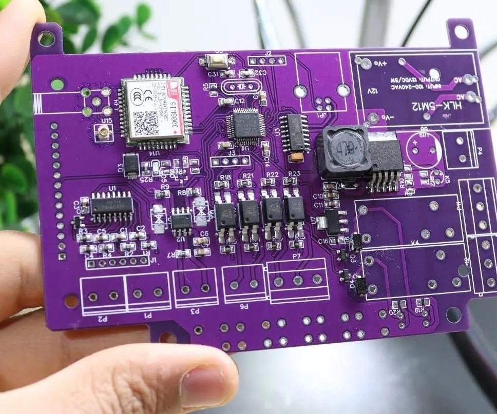

Step 3: PCB Design
The PCB design is one of the important parts in any proffesionnel product, where we start chosing the right packages according to the right components , make your first order for free :
https://www.nextpcb.com/?code=electronichobbyy

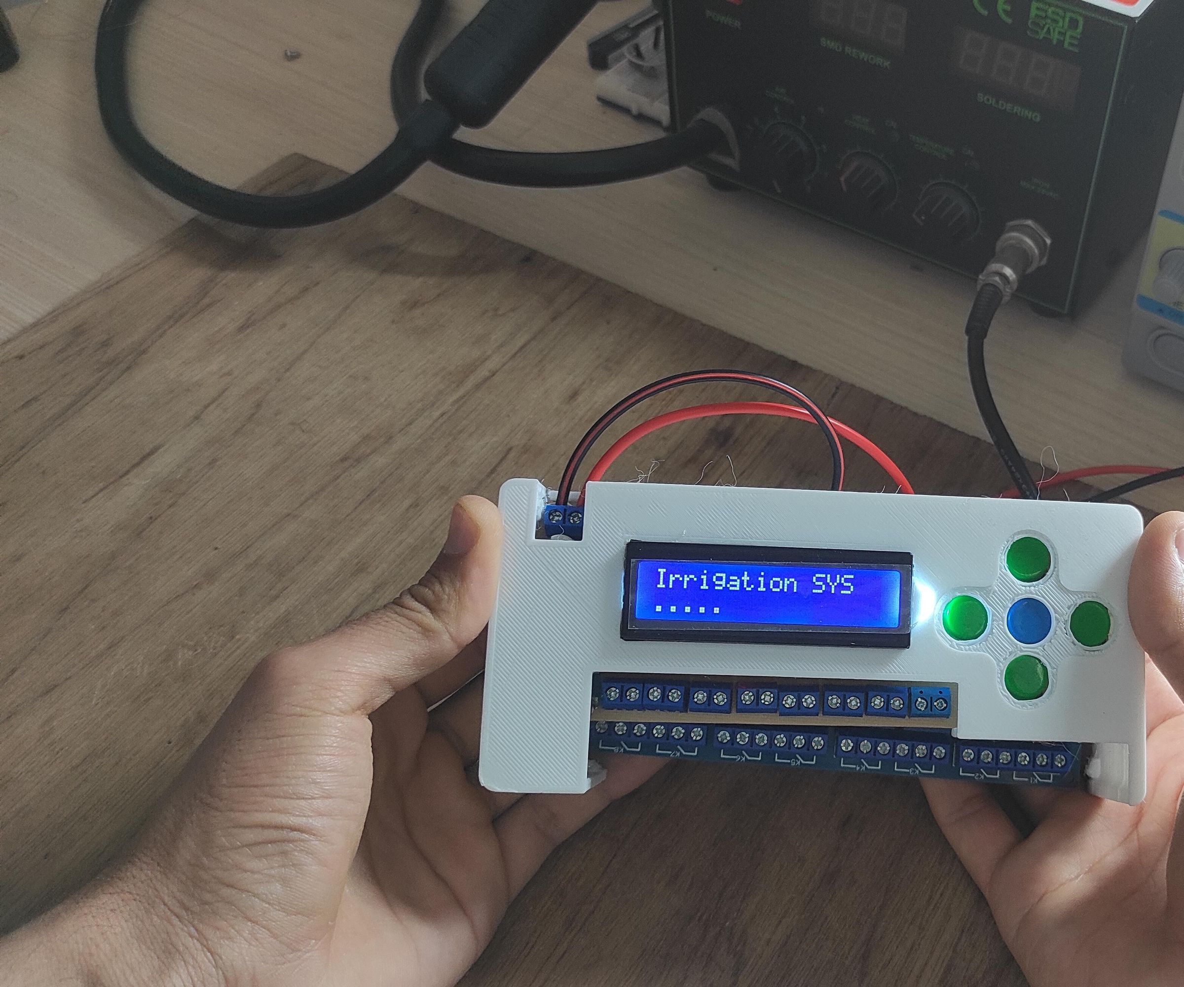

Step 4: Soldering & Testing
More details in the video below :) !!
