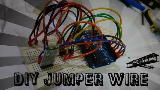

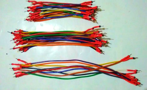

Introduction: DIY Jumper Wires (male to Male)
A jump wire, is a short electrical wire with a solid tip at each end (or sometimes without them, simply "tinned"), which is normally used to interconnect the components in a breadboard. Follow this procedure to make your own.
Step 1: Gather the Requirements
Step 2: Measure and Cut Wires From the Ribbon
Make the length to suit your requirements.

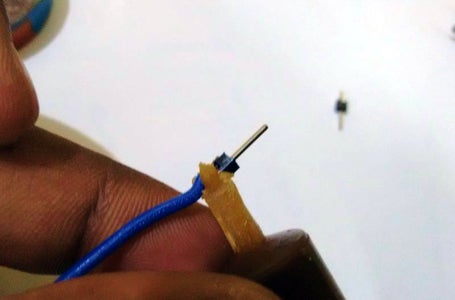

Step 4: Strip the Sleeve and Twist the Wire

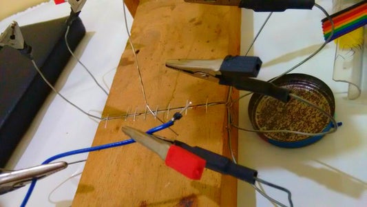

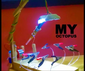

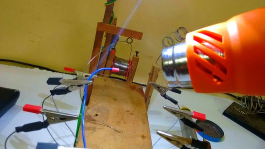

Step 5: Fix the Header Pin in Octopus. Check the Link for Build Instructions -->> Octopus
Step 6: With the Help of Helping Hands Solder the Pin to Wire
Apply flux

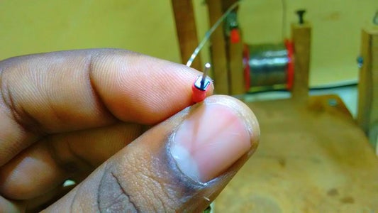

Tin the tip
Solder

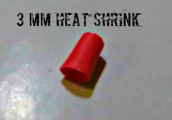

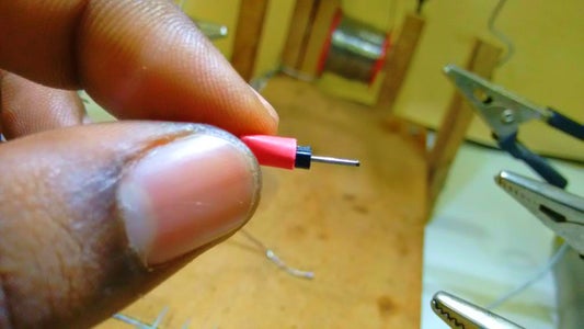

Step 7: Insert Heat Shrink Sleeve and Shrink It With Hot Air Gun
