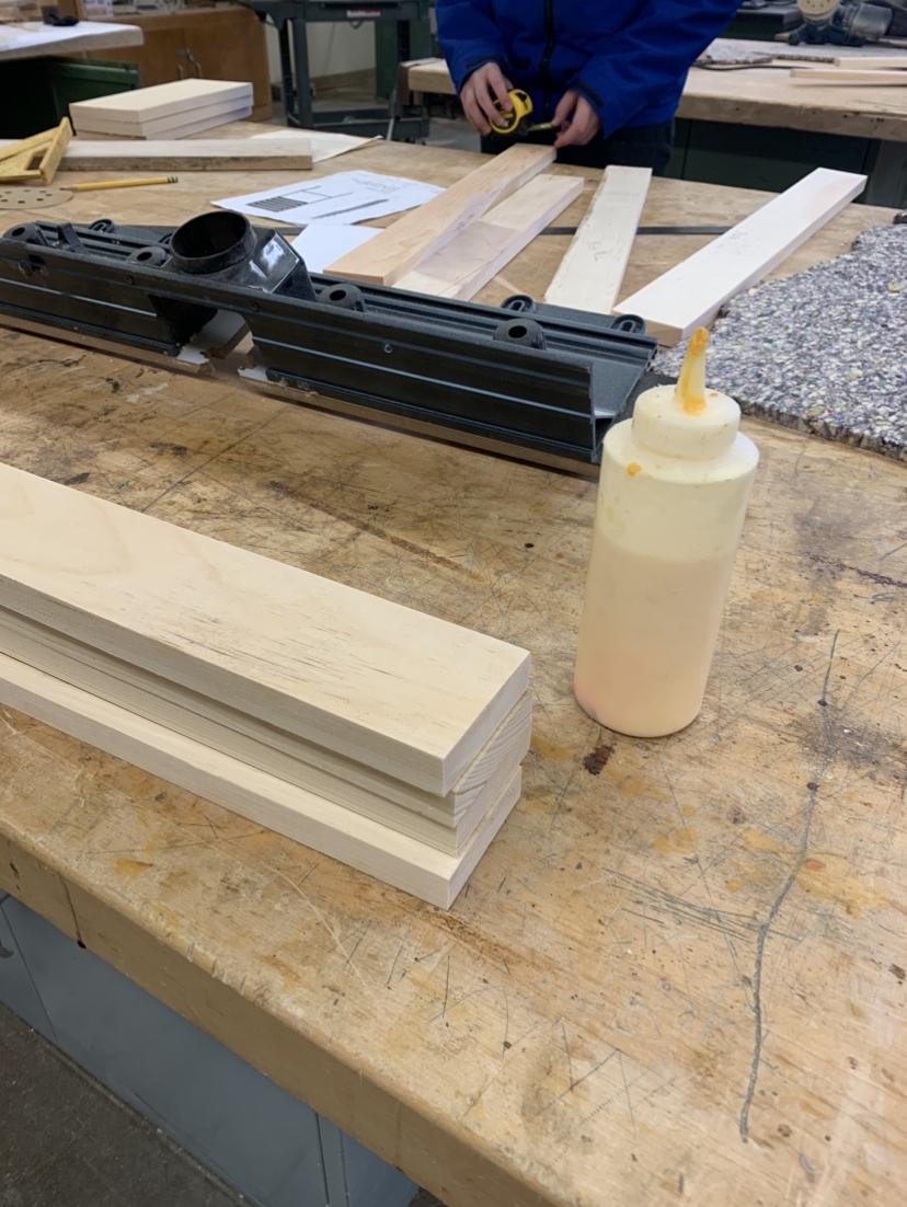

Step 1: Prepare Pieces
Cut 4 peices off of the pallet. Next plane them down to the desired thickness. Cut all pieces to specified dimensions.

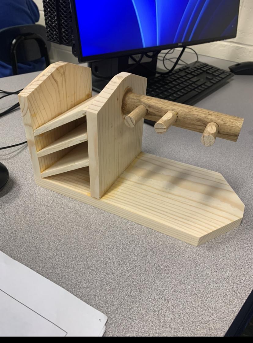

Step 2: Assembling the Key Holder
After cutting the uprights for the phone holder, take one of them and drill an inch in diameter hole on the center top. Next drill 3 holes of the specified distance apart into the dowel rod.
Step 3: Glueing
First, draw a line of the correct spacing between the two up rights. After letting the up rights dry for 5 minutes, now you can glue in the phone slots. After they have set for 10 minutes, then you can glue the key holder part to the hole in the inside up right.
Step 4: Sand and Finish
After all the glue has dried, you can finish sand all the surfaces to 220 and oil the stand if you please.
