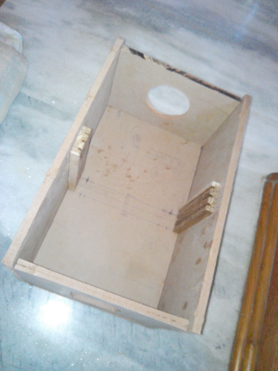

  1. Play wood (mdf) sheet to make box

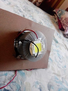

  5. 100w high power led with driver

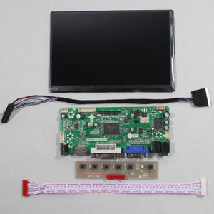

  6. LCD panel and its controller. I used 1280*800 7”
    HD lcd and controller.

  9. CPU heat sink for led .

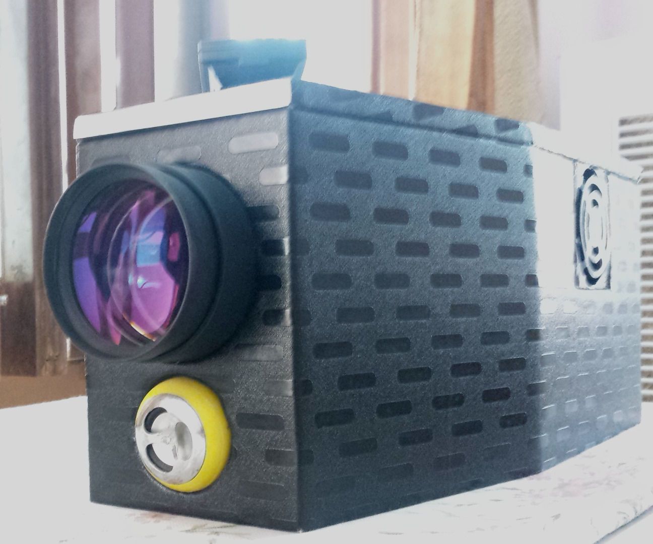

Step 5: Final Projector Ready for Action
Front and Back View of Projector

1. 100w led and driver : One can easily find 100w led and driver on ebay.com. I bought mine on ebay.in @ 1500/- INR.
High power 100W white
Chip size: 24*40mil
Color temperature: 6000-6500k
Luminous intenity: 8000-9000lm
Forward current: 3000mA
Driver voltage: 30-36V
Light angle: 160deg
Integrated scheme: 10 in series, 10 in parallel

4. LCD panel : I use N070ICG-LD1 HD LCD Panel and Controller Kit in this projector. It is the best available LCD in 7" size and controller support all input like HDMI, Pandrive, AV,TV in and VGA. It is also come with remote so easily can control pj remotely. The total cost of this LCD with controller around 6000/- INR.
LCD Features:
N070ICG LD-1 is a 7 inch HD LCD with native resolution 1280 X 800 It delivers a sharper image with good colours. This is very unique LCD.
Backlight: LED
Resolution: 1280 X 800
Ratio: 16:10
Colours: 16 6 Bit dithering)
Glass Thickness: 0.25mm
Make: Innolux
Contrast Ratio: 800
Pin: 40
Surface: Glare
Operating Temperature: - 20 to + 60 degrees
Controller Features :
HD Controller, will work with N070ICG LCD. This controller comes with remote and you can operate almost all with remote itself. The USB port can Play Most of the Videos Format flawlessly.
