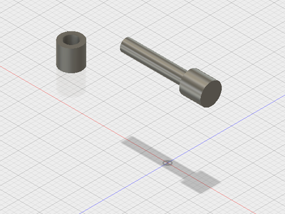

Step 3: Pieces and Files for 3D Printer
Here you will find the different parts designed on Fusion 360 and the files related if you want to download them. On the gif you can clearly see that the "grabbing piece" goes up and down when the lever is used; this way it can pull up or push down on the suction cup and increase or decrease the pressure inside.
