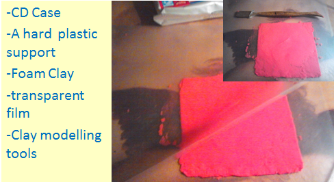

Step 1: Inventory
-CD case for pressing evenly and making rolls
-a hard support
-plastic sheets
-modelling tools
-foam clay
-a pencil
-a ruler
optional:
a modelling extrusion syringe to extrude thin noodles
Starting procedure
-Take Foam clay from one brand like Fimo or Hobby time or even if you know a recipe to do it yourself go for it
-make a square sheet 0.5-1 mm by pressing ang cutting it accordingly About 11-13 cm width and heigth.
-let it dry between two sheets of transparent paper or wax paper. (overnight/nearby a heating source like a home radiator)
During drying, please put weight on both side, to get the sheet of foam clay flat. (Otherwise it goes curved... you do want it flat right!)
-once dried, released the square sheet from its support like shown on the picture
