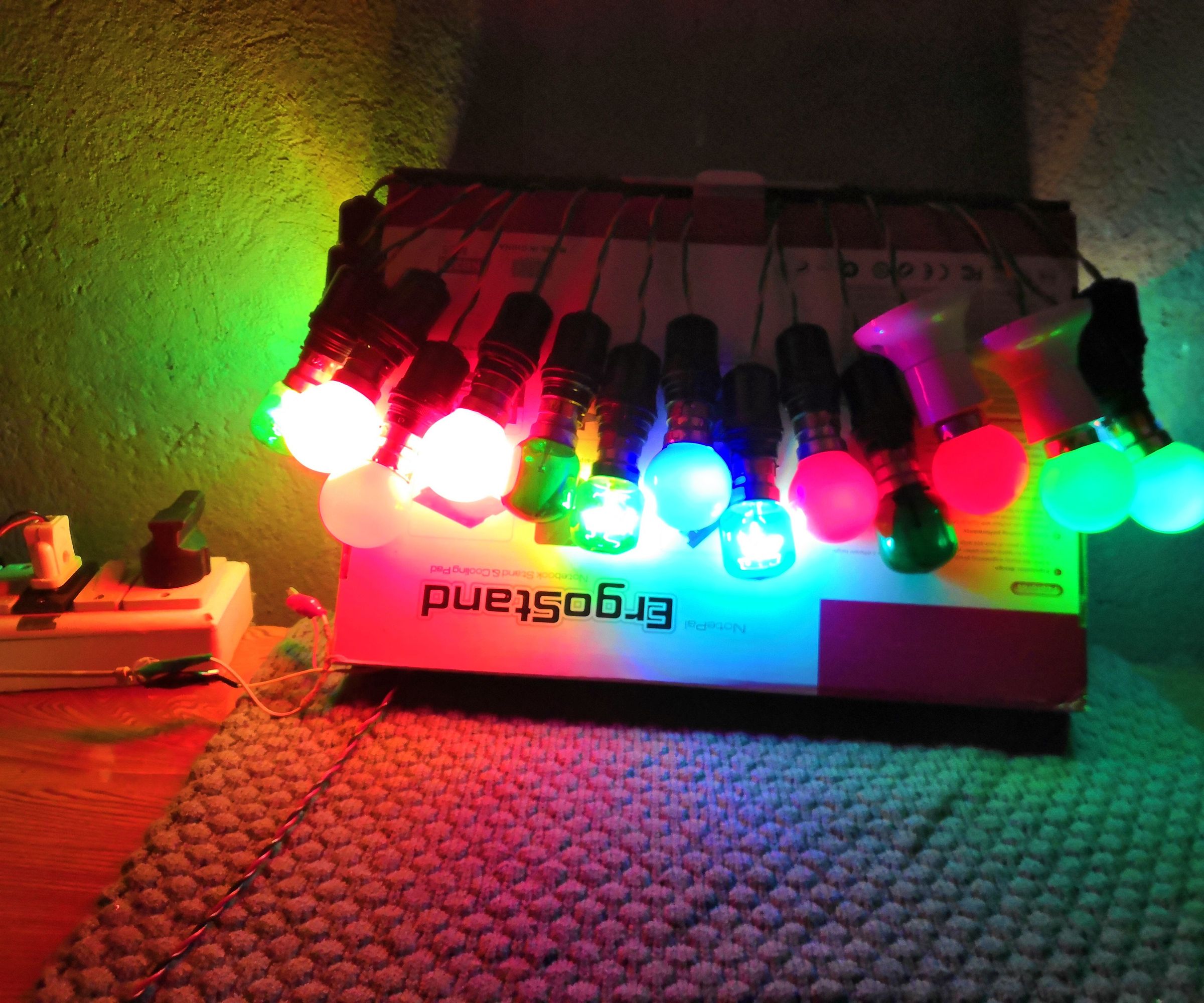

In this project I will show you how you can make a massive 12000 watts led light controller.
This is a 12 channel setup, by using this circuit you can control any 230v light.
You can make different pattern of lighting. In this video I will show you a demo programming but you can make it according to your requirement.

Now put all the components to the board & solder it...
Step 7: Connect the Power Supply
Now connect the 230v power supply & the 5v power supply....
Also connect the load..
