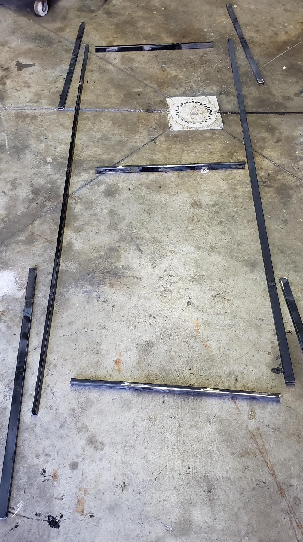

As mentioned above, I gained some metal bars from cutting pieces off an unused display panel. I was left with a bunch of bars cut at different lengths. Using my tabletop as a guide to determine what lengths I needed to create the frame. Once I had dimensions, I welded the bars together to get the sizes below.
x 3 – 6ft. bars
x 5 – 23in. bars
x 4 – 29in. bars x 1 – 6ft
x 2ft Wooden tabletop
(Optional)
x 2 – 6ft x 1 1/2in x1 1/2in
x 4 – 5in shelf brackets
x 2 – 4ft x 5 1/4in x 1/2in plywood
If you do not have access to reusable materials, then purchasing new is still a cheaper option than buying a prefabricated desk of the same style. Plus, you also get to experience building your own metal frame desk.

Laying all the materials out will allow you to confirm your materials match the design. This is also a good time to review your design if there is anything you would like to add or change and what material is needed.

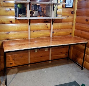

At this point you may wish to keep the desk as it is and add some stain or paint or even dress up the wood a little. Personally, I ran a wood router around the edges of the desk to make soft rounded edges.
Step 4: Add Shelves (Optional)
At this point you have a perfectly functional metal frame desk. I on the other hand, wanted to take it one step further and add some shelves to help keep me organized. Below is how I set that up.
- Start by measuring inwards on both sides of the desk 2ft then make a mark on the top and bottom bars.
- Predrill the marks
- Next, line up the two 6ft 2×2 boards (actual 1 1/2in x 1 1/2in) with the predrilled holes standing straight up.
- Use a level to make sure the boards are standing straight and then fasten them to the metal bars using a metal screw wherever the board crosses the bars.
- Measure up 19in from the surface of the desk and make a mark on both vertical boards.
- Do the same measuring at 33in this time.
- Now install the shelf brackets using the marks to line up the top screw hole of the brackets.
- Once the brackets are in place, install the 4ft plywood over top and fasten down with some smaller screws.
Now the metal frame desk is constructed, and the only thing left to do is decorate. I chose to stain my desk and later put on a few coats of polyurethane.
