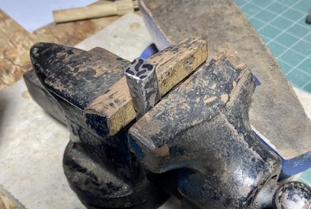

I filed the end flat (pic 1), marked the face (pic 2), and then used a tiny triangular file to make a couple grooves (pic 3). At this point I thought that I could make the process easier by taking those grooves to the bandsaw fitted with a metal cutting blade. The idea is to help my larger triangular file ride those grooves, pic 4. Once those cuts were made, I use the bigger file in order to make my checkerboard, pic 5 - 7.

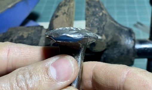

To get the third pattern out of the head end of the railroad spike, I stuck it in the vise and used my angle grinder to thin the end out even more, pic 1 & 2. Afterwards, I used a small hammer to create a curve in the newly thinned metal, pic 3.

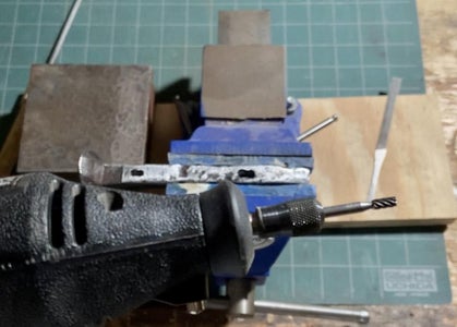

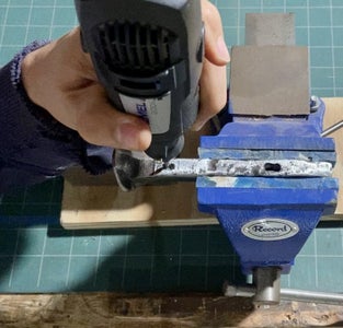

Moving on to the spike end now, I wanted to create an irregular pattern. I used a marker to draw some shapes and then took the round bit on my rotary tool once again to cut the grooves in. This was another process where taking your time, limiting your coffee intake, and steadying your hands really helps.

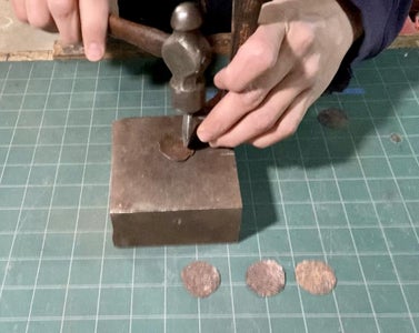

I had some leftover copper pieces from my apothecary cabinet build and so I decided to take five of those for each of the five patterns. I used a steel block that I had laying around as a base and started hammering them out.

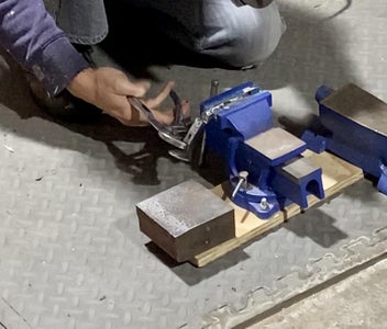

I used a small punch, pic 1, to allow a spot for my 1/16-inch drill bit to "bite" into the copper and went to work, pic 2 - 4. This left a small burr on the backside, pic 5, so I used a small file to smooth it out, pic 6.
