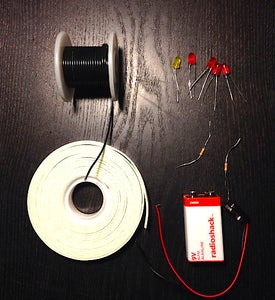

Here are the list of items that you'll need to add LED's to the 3D printed part.If you plan on sending out a Radioshack gift card you will need a minimum of 15$.
4 Red Leds
1 Yellow LED
2 220 Ohms resistors
9V battery
9V battery snap connector
Double side Foam tape, depending on where you want to place the Tree
Bread-boarding/Hookup wire

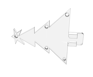

  • MiniTree.stl file should take about 35-40 minutes to print
  • BatteryBaseBox.stl should take about 25-30 minutes to print
Step 3: Adding LED’s to the 3D Printed Tree Part

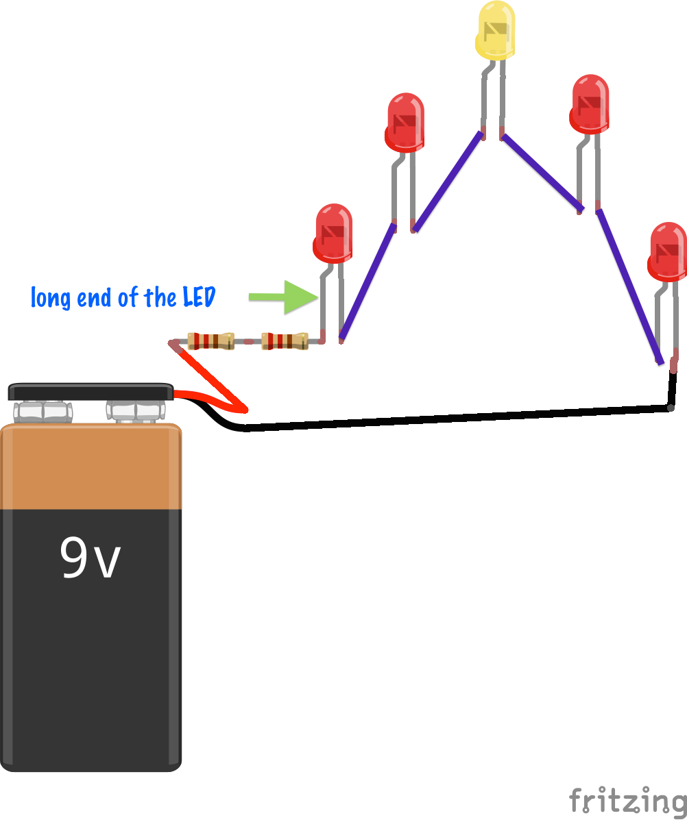

Press the LED's in the 3D printed Tree part and follow the circuit diagram attached.
Twist the LED ends again, connect the longer end of one LED to the shorter end of another LED.

Twist the two 220 ohms resistors together and connect it to the +ve terminal of the battery
Connect the -ve terminal of the battery to the shorter end of the LED's
Now twist the other end of the resistor and connect it to the long end of the LED's.
You should see the LED's glow!

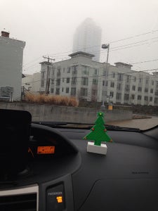

Now if you plan to put the Tree on your Car dash for the Holiday season, it would be a good idea to solder the components together as shown in the picture above(Note: Please ensure that this is not a distraction to the driver)
In addition use double stick foam tape to the bottom of the battery 3D printed part and you are good to go..
