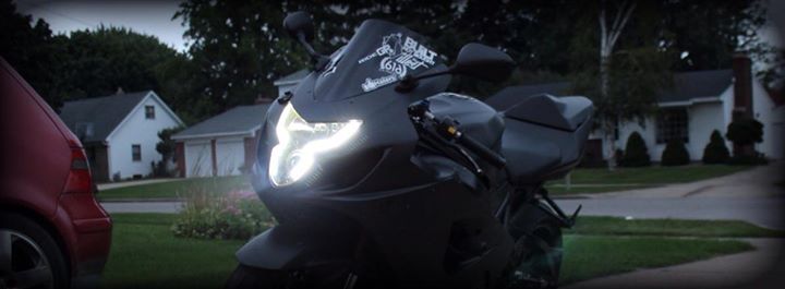

Introduction: DIY Motorcycle LED Daytime Running Lights (DRL) Mod
UltraBright™ Design series Bright White LED strip lights for this distinctive DIY motorcycle LED DRL mod.
To install the lights, start by cutting the LED strips to size.Then solder the strips together and set them in a plastic fiberglass casing he made himself. As a finishing touch, he coated the fiberglass casing in black to match the color of his bike using a product called Plastidip by Performix.
The 12v DC lights were then wired to the battery (which also runs at 12v DC) so they would come on every time Nick starts the engine.
