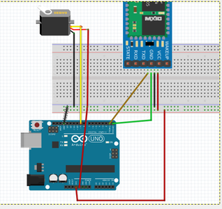

Step 2: Step2: Connect the Module Bluetooth
This module is compose of 4 pins:
RXD====> Pin which collect information from the app = TX (pin 1) of the Arduino
TXD====>Pin which send information to the Arduino = RX ( pin 0) of the Arduino
VCC====>Pin connect to +3.3V of the microcontroller
GND====>Pin connect to the GND of the Arduino
The two other pins were not use in this projet. This module can tap at 10 meters around this installation.
Step 3: Step3: Connect the Servo Motor
This servo have got 3 pins:
one jumper brown==> it is the GND
one jumper red====> it is the VCC
one jumper orange=>it is the Vout ( the signal)==> connect to the digital pin 9.
This servo is not the most powerful but if you have got tight budget is good.
