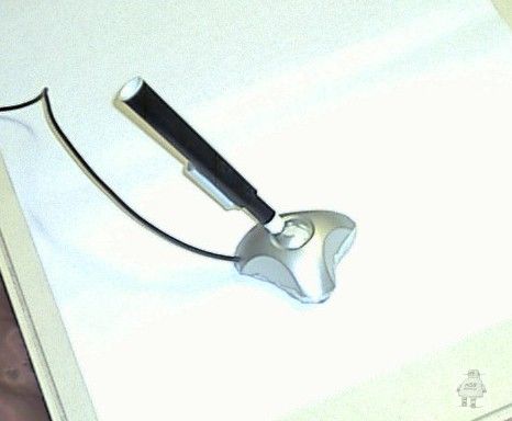

Have you ever wanted to have your very own handwriting in a document, wanted free hand sketches,etc.Well, for me I have always wanted to.And as a DIY guy I wanted to build such a device for myself but days of internet search yielded no results. I later had an idea on it, I applied it to the optical mouse and it worked!!! I will like to share it with you guys.And PLEEEEASE do not forget to vote for me. Teach it contest and Tech contest.

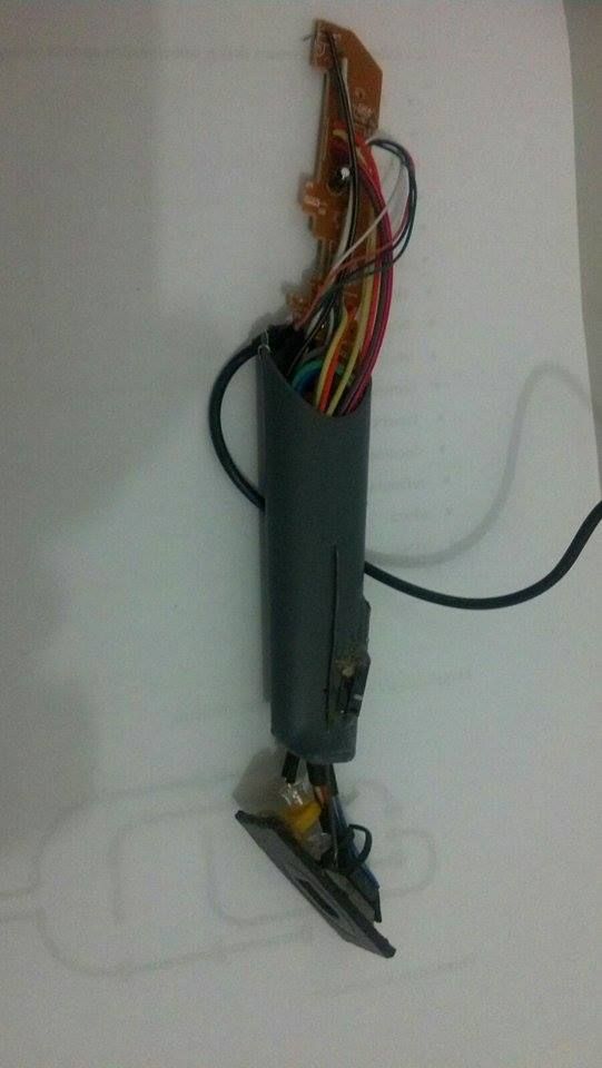

Step 6: Preparing the Aluminium Casing
The sheet of aluminum should be
marked and cut ot basically as shown in the image but with actual dimensions according to your PCB size. We then need to fold the sheet of metal as shown.
Cover the open side with the plastic as indicated and apply some epoxy glue to bind the plastic to the aluminum case.
Your PCBs (Left and right ) should be able to slide into the case now. Desolder and remove all the us USB wires, pass it from outside into the case and solder them back onto to PCB. Then Insulate the PCBs with cello tape before sliding it into the aluminum case.
Finally attach the lens structure with the sensor as shown in the picture above.Now screw it to the aluminum case.That's it! We are done!
