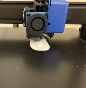

Step 2: Print Base
I used Overture PLA filament to print the base. I decided to use PLA because it was more adhesive to the print bed than PETG.
I used the generic PLA setting in Cura, but changed the nozzle temperature to 210° Celsius.
Step 3: Print the Posts
With printing the posts I had issues with warping, to fix this I found that printing with a raft made the print come out much cleaner. I Also had trouble with tolerances, I originally used a .1mm tolerance which worked in some instances but not all. You can change the parameters in the f3d file I attached.
