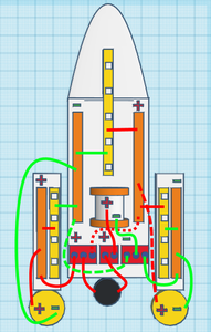

I made two prototypes to figure out the final design and where to add the components. I designed a 2D model in Tinkercad and added the wiring in paint.net.

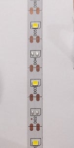

I also cut out pieces of LED stripes in the preferred length as well.
All LEDs set to run at 4.5 V and run off three AA or AAA batteries.

2.3 The Wiring
I took a red wire for the positive pole and a green wire for the negative pole for most parts of the build and started to find out which connection would make the LEDs shine.
I forwent soldering and taped, glued, pinned, tacked and crimped it. For some parts of the cable links I used lever nuts - this made it very easy. BUT to be completely blunt: Not soldering isn't the most reliable solution.
