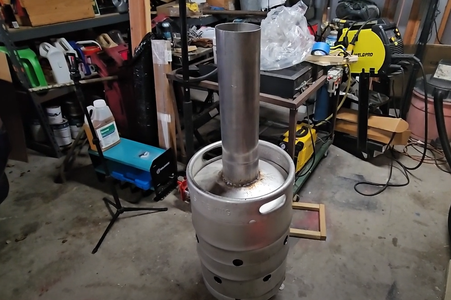

What I've built here is a stove/ patio-heater made from a 15.5 gallon stainless steel keg. It's great to have in the event the power grid were to ever fail, or if you just need some extra heat on a chilly night. One fire log fits perfectly down the smoke stack and the whole keg glows orange when the fire gets going. Better yet, it is almost entirely smokeless. Oh and did I mention its stainless? So the barrel will never rust!

Step 2: Drill Out the Chimney Hole
After making sure there is no pressure in the keg, Start with the 2-1/2 hole saw to remove the keg stem, then using the scrap wood cut a 5in hole to use to center the 5in hole saw in the top of the keg.
Step 3: Measure and Cut the Side 2.5in Vents
In this step you will need to measure 6-3/4in from the bottom of the keg for the lower holes and 12in for the upper holes. Each hole is 8in apart. Cut holes using the high speed setting on your drill, the bits seem to last longer doing it this way.
Step 4: Drill Drain Hole
Flip the keg upside-down and drill a small hole in the bottom. I used a drill/tap combo which fits an M8 size stainless bolt.
Step 5: Adding the Legs
Cut 3 equal legs from your steel tubing, space them equal distance apart.
Step 6: Welding
Weld the legs on first, then stand the keg up on the legs, center the 5in pipe and weld it on flared side down.
