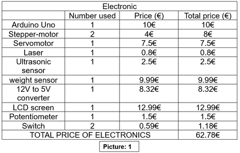

In this section, we have compiled a list of all the components we used along with their prices. In photo 1, we can see that the cost of the electronics amounts to €62.78. Photo 2 shows that the cost of the components is €11.781, while in photo 3, the cost of the 3D printed parts is €12.06. Photo 4 displays a cost of €4.604 for the laser-cut parts. Combining these prices, we can conclude that the total cost of the finished prototype is €71.225.
It is also important to mention that the tools and supplies required to complete this project is:

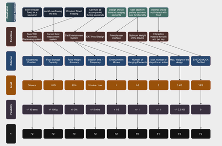

Step 3: Functional Analysis
In this project, as in any other, there are certain constraints for the product to be good enough for its purpose. To know the limitations, it is first necessary to understand the objectives, what the product will be able to do and what it will not be able to do.
Objectives
- Providing food for a weekend: enough food to feed the cat during this time.
- Provide adequate food at the correct times: do not give too much or not enough food during each meal.
- Effective entertainment: to entertain the cat for the necessary time.
- Cat-safe design: the cat cannot hurt itself or break the device.
- Ecological design: recycled materials and environmentally friendly manufacturing processes.
- Friendly user interface: to change parameters for feeding.
- Economical design: good value and affordable materials.
- Optimum weight of the device.
Keep these goals in mind at each project step. Work towards achieving them throughout the project, ensuring the final product meets all these objectives.
Constraints
These objectives are linked to some constraints implemented in the device. First, the constraints will be named, described, and ordered by their priority, and then the link between the constraints and the objectives is shown in the attached table.
These constraints must be used to design and build the product. The relationship between the functionalities and the constraints and the values of these constraints are shown in the attached user requirment list.

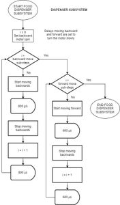

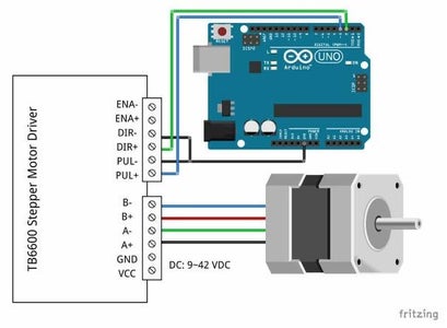

This is section will present the mechanical design of the subsystems. In our design, feeding subsystem needed a comperhansive mechanical design process since it will be the only subsystem that should endure considerable stress. Additionally,
Feeding Subsystem
This subsystem was the one responsible for delivering food to the cat with specific quantities.
- Requirments
As discussed in the past seciton, the user citeria sheet is basis of the whole design decisions. It can be seen that the first criteria are specified for the feeding subsystem as follows:
- Dispensing Duration - MAX 30secs
In order to achieve such a criteria different concepts has been studies and evaluated as shown in the following section.
- Conceptual Design
Multiple dispensing mechanisms has been evaluated as shown in the figure. These different methods are commercial mechanisms that is already in use for different pet feeder devices. However, the purpose of the project is to secure food for a weekend long which sets some advantage designs over the others.
Gravity Passive Dispensing: Althoug this is the simplest solution, it does not serve our project core as it cannot provide portion based feeding.
Gravity Active Dispensing: The active dispensing provides the best trade-off for all dispensing requirments.
Passive Dispensing with Guiding Door: This mechanism provides the required function for feeding, but it is complex to ensure that the feeding happens in the right duration.
Rotating trays: This mechanism shows the required function for the device. However, it is not feasible to make such a mechanism that can take the required amount of food in the requirment list.
Based on the weights given for each solution, the gravity active dispensing will be the best compromise for the project requirments.
- Embodiment Design
The gravity active dispensing is basically a slotted wheel rotating in a cover. Each slot on the wheel will represent a dispensing portion. After design optimization of the overall dispensing size and number of slots on the wheel, we were able of achieveing 6 grams resolution of cat food. However, after testing the mechanism, the food wasnt filling the slots fully, therefore, the typical resolution of each dispensing portion is 3g. based on the calculations: at dispensing speed of 0.5 RPS, it takes around 2 seconds to fill the bowl of 50 grams.
- Material Selection: The material has been chosen to be PLA polymer. PLA provides excellent mechanical properties of Yield Strength of around 57 MPA and Impact strength Charpy of around 13 - 14 [KJ/m2]. These properties qualifies PLA among many other polymers. However, the most intersting property for PLA is heat stability, which makes a best candidate for FDM 3d printing. In order to 3D print such a material, there is no special enclosures or setup required.
- Design for Manufacturing: As discussed the design was chosen to be 3d printed. Therefore, all the parts are optimized to eliminate the use of support material to save the resources.
- Design of Assembly: The figure shows the assembly guide for this subsystem. The design uses only M3 screws. Additionally, the tolerance of the wheel is iterated to provide anti-slip easy fit.
- Final CAD Design
The figure attached shows final CAD for this subsystem in both operational and assembly configurations.
- Testing
After testing the first prototype of this subsystem, we faced an issue that the cat food has relatively big volume and very hard structure. Additionally, the cat food has different shapes from one manufacturer to another. All of these makes the food frequently gets stuck in the dispenser. A valid solution for the problem is to use a driver which can measure the back-EMF of the stepper motor and change the motion to unclog the food stuck. However, we choose to fix the problem which a solution that depends only on the components we had. We programmed the stepper motor to make oscilatory based dispensing, which after many testing it showed that it solves the problem without the need of getting new components. The video attached shows the intended motion for dispensing.

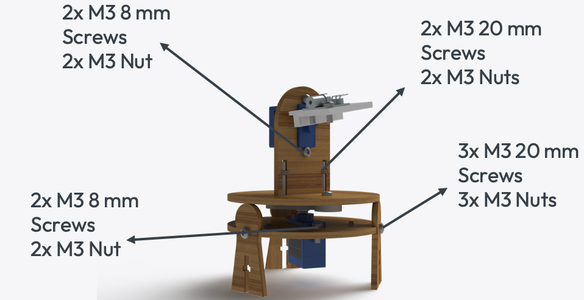

Entertainment Subsystem
This subsystem is responsible for entertaining the cat using laser pointer.
- Requirments
As discussed earlier, the user requirment list had the following requirments which are related to the entertainment.
- Session Frequency - 10 mins / hour
- Entertainment Modes - 1 Modes minimum
- Conceptual Desing
Pet entertainment can be achieved using various techniques as shown in the attached figure. Following the assessment criteria, the laser entertainment is the best solution for our criteria.
- Embodiment Design
In order to implement an automatic laser pointer to entertain the cat, there should be two independent axis movement for the laser module. Although such mechanism can be easily implemented using 3d printing, however, the mechanism is chosen to be designed for laser cutting to reduce cost and have bit more design challenge for the team. Additionally, it was required that the entertainment area will be 1 m long and 0.5m wide in front of the device. The user is required to leave this space empty in front of the device to make sure that the laser will obvious for the cat. The attached illustration shows the concept.
Material Selection: The materials will be 3mm MDF connected together using M3 screws and nuts. It is worth noting that the motor couplers are made of PLA plastic parts.
Design for Manufacturing: since it was decided to use laser cutting for the mechanism. the design had to be optimized to be composed of sheets that can be mounted on servo motor for each axis as shown in the attached figure.
Design of Assembly: Since this design includes motors, 2d sheets, 3d printed parts a simple assembly interface is designed to make the assembly of the project seamless. The attached picture shows the assembly guide for the entertainment subsystem.
- Testing
The mechanism performed as expected, as the laser module was able to be precisly controlled in the X and Y direction. The mechanism was also self supported in which the geometry of legs was supporting the weight of the mechanism without the need for a bearing.

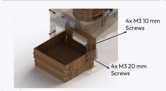

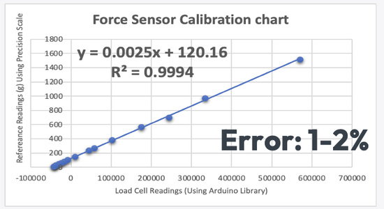

Food Monitoring Subsystem
This subsystem is meant to measure the weight of the food in bowl to make sure that the any dispensing operation will not result in overflowing for the bowl.
- Requirments
The design doesnt require much of a mechanical design since it has no considerable load or motion. However, it was required to be designed from two compartments connected to a force sensor and the food compartment is allowed to apply pressure of the force sensor.
- Embodiment Design
The desing was made two seperate compartments connected to the a force sensor in the middle. The upper compartment is meant to carry the food, but the bottom design is meant to support the whole subsystem as shown in the figure.
Material Selection: The materials will be 3mm MDF connected together using M3 screws and nuts. However, the sensor is mounted by M4 screws to match it is threads size.
Design for Manufacturing: It was decided to manufacture the bowl by laser cutting for different sides, and all of them will be jointed together using m3 screws and nuts.
Design of Assembly: The figure attached shows the fastners needed to assembly this subsystem sheets together.
- Testing
The design has been tested by reading the weight from the weight sensor and make sure that it is sensitive enough for small weights to be detected by the weight sensor.

Food Monitoring Subsystem: A weight sensor is required to accuretly measure the weight of the food in the tray. It should be very sensitive since the density of the cat food is really small.

Feeding Subsystem: In order to control a stepper motor, a stepper motor driver is required to seperate the high power side of the motor from the low side of the microcontroller. Additionally, since dispensing involves high power and multiple stall positions for the motor. A reliable, high power motor driver has been used which is TB6600 known for industrial use for stepper motors. The first figure shows the circuit for the stepper motor. For the power requirements: After several tests, the stepper motor needs 12V power with around 0.9A at the stalled position.

Food Monitoring Subsystem: To monitor the weight of the food, we decided to use the a load cell sensor. The load cell will be accompined with HX711 module which includes a ADC, and amplification circuit. However, during the testing the sensor, the sensor was not accurate. Therefore, a calibration experiment was conducted by measuring various objected using precision scale and curve fitting the data and extracting the relation between the measured data and the real weight data as shown in the figure attached. Using the formule deduced from the figure, the accuracy of the weight measurment was found to be 1-2%, which matches the user requirment sheet dicused in the above sections. Such module only deducts around 2mA only.

Final Circuit
The figure attached shows the full circuit of the device with the power power circuit and the exact components and pins used. Please note that this circuit is what used to design the PCB. Using the pcb will just make connected the components to the shield at the specified ports.
Testing
The electrical system has been tested several times before assemblying the device. The power circuit has been tested also for various load conditions to ensure that the system will work with considerable saferty margin and the system has the required safety features in case of over voltage, over current.

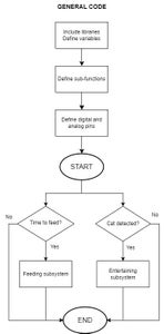

Figure 1 shows all the code's steps to achieve all these objectives.

Stepper-motor for dispensing food
The stepper motor makes the dispensing subsystem rotate and give food portions. Using the “dirPin” and “stepPin”, the direction and activation of the motor are set respectively.
Due to the food, the motor can get stuck. The initial idea to solve this problem was to use a current sensor, but the plan changed to save money. Instead, in every dispensing step, the motor goes backwards some angle and is set to go forward dispensing the food. This solves the problem, so the motor does not get stuck permanently.
The motor velocity going backwards and forward is set using microsecond delays as shown in the flow diagram of the Figure 2.
Feeding subsystem and weight sensor
In this subsystem, the food is given to the cat using the Dispenser Subsystem and the weight sensor to know how much food is given every step, as the diagram shows.
The sensor had some problems because it disconnected every time the food was dispensed. Finally, it was figured out that the delay between the measurements was important and decisive to avoid error.
The same error was due to the measurement being done inside a function called every time the weight was wanted to know. This problem was solved by using the main loop for this function. The logic followed to feed the cat can be observed graphically in Figure 3.

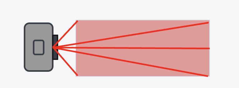

Distance ultrasonic sensor
Used to know if the cat is nearby and turn on the entertaining subsystem.
The initial idea is to use it to know if the cat is coming when the food is being dispensed, consider the amount of data dispensed so far and give the remaining after the cat is gone. This should be done because the weight measurements are wrong if the cat eats.
Due to lack of time, it has not been carried out. Instead, the food is given to the cat until the weight sensor measures the desired weight of food, no matter if the cat is detected.
The Trigger Pin is used to send a signal using the ultrasonic device, and the Echo Pin reads the rebound of the signal that has been initially emitted. Measuring the time between the two signals and knowing the sound's velocity (343m/s), the cat's distance can be detected with the following equation. Consider that the sound has travelled double the distance between the cat and the device.
Distance= duration*0,3432
The function works sequentially, as can be seen in Figure 4.
Cat entertainer
The subsystem to entertain the cat is a laser device as described below. It is moved by two servo motors to move in two degrees of freedom. This is done by setting the number of points the pointer will reach during the entire entertainment time. The game has ended once the laser has gone to all these points. The angle of the motors at every point is random but always in the correct range to be seen on the floor. The diagram in Figure 5 describes every step in the code to move the servomotors and the laser device.

Cat Entertainment Subsystem: The third figure attached shows the assembly instruciton of the entertainment subsystem to the frame. It is seen that the system has three holes for three screws and nuts assembly to fix the mechanism on the plate.

The Frame: The outer shell of the deivce is basically a 2D sheets are connected together using 2d fingers. A standard M3-20mm screws and nuts are used to fix them all together.
