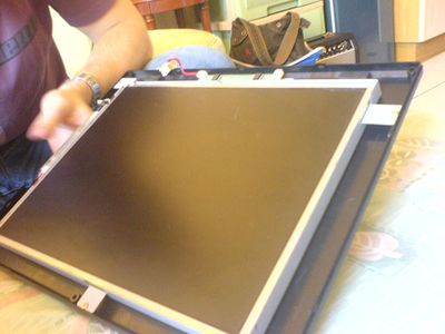

First, get the LCD glass out of the monitor by carefully unscrewing, dismembering and prying. Be careful around the wires and you should be fine. One handy thing is that on mine, the display cable was detachable from the motherboard, so that made it easier. It's helpful to have a second pair of hands for this, in my case, I used my girlfriend's.

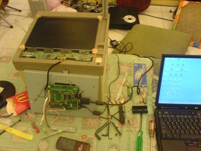

Step 2: Initial Assembly and Test

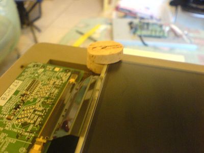

The hardest part is over. Now it's just a matter of coming up with some sort of mounting and enclosure construction. You're going to want to space the screen up from the projector window, as it gets super hot, and could damage your LCD. I used a cork, cut into four pieces and slit 50% down the middle.
I found that my projector was overheating and shutting off by itself, so I mounted a fan on the inside of the casing to get the air moving a bit.

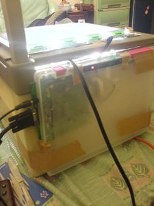

With all the plugging and unplugging I was doing of all the components, I felt like the power jack on the mainboard was getting a little flimsy (it's only held on by solder, I think), so I put the entire board inside a document protector, which closed pretty well with only the jack and the VGA port sticking out.

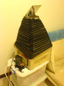

After a brilliant suggestion from Alyosha, I have since created a bellows as a variable-height enclosure. I will be posting a separate instructable for it presently.

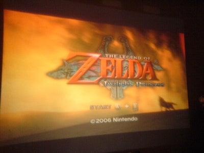

Sorry about the poor quality of the picture, but I had to take this with my mobile phone. There is some light spill-off from the projector itself, I later ended up covering the sides with a black plastic bag temporarily (it needs some vertical give to adjust the focus).

I have just finished creating a bellows that serves as a wonderful variable height enclosure and keeps the light spill-off to a minimum. See step 3.
