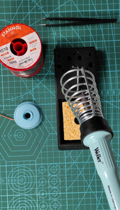

The tools is up to you to define based on your skills, You can assemble the circuit using only a solder iron and solder core if you have some assembly skills but here I share the tools that I used easily complete the assembly of the Surface Mounted Parts, you may find that some tools are extra but you consider that it depends on your capabilities.
  • I used a low temperature profile solder paste from CHIPQUIK SMDLTLFP10T5
  • I used precision tweezers to deal with the small components.
  • The small size hot plate MHM30 from miniware is suitable for the size of my circuit and I used (optional) a digital microscope camera to inspect the assembly results.

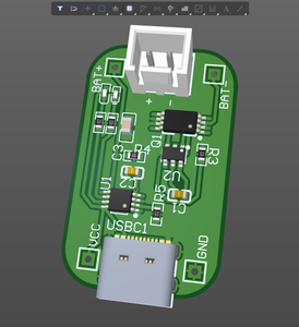

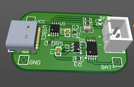

Step 2: The Circuit Design
After getting the schematic ready I transformed it into a PCB design and placed the parts in a small board size layout as always, since this is a circuit prototype to test the parts connection then no many things to consider about the routing.
After getting the GERBER Files of my circuit design ready, I moved to JLCPCB and I uploaded my design files to place a PCB order from them, I selected the minimum settings for economic order price and due to the very small PCB design size I got my boards for free.
